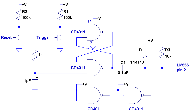

It would have been simpler if you had said that in the first place. There are lots of ways to do this, but this is probably as good as any. I added a reset switch. You can eliminate the reset switch and have it work only once after each time the power is turned on. Here is the CD4011 datasheet.
Could you explain to be why you have the 0.1uF capacitor, diode & resistor. The circuit seems to work fine with just the R/S latch network.
When the trigger switch is pushed, the latch output (the lower output of the cross-coupled NAND gates) goes low and stays low until reset. Pin 2 of the 555 has to go low to trigger it, but it has to go back high before the 555 times out. The capacitor and 10k resistor form a differentiator to assure that this happens - just like in the previous solution I described. The diode is protection against potential excessive current into pin 2 of the 555 when you reset the latch. You didn't need the diode in that circuit, because the 100k pullup resistor on the switch limited the current to microamps.

Regarding your circuit - it is definitely simpler than the one I suggested. I do have a critique, which I inflict on many posters. Feel free to reciprocate.
99SH wants the output to be a positive pulse, so you need to add an inverter, which is not a problem, since you have at least 3 left over.
What is the purpose of the 1uF capacitor? I think this will guarantee an output pulse every time power is applied - probably not desirable feature.
Are you sure the latch will come up in the untriggered state every time you turn on the power? Speaking of that, my latch has this problem. I have edited it to add this feature.
Your LED is backwards, and needs to be connected to +V.
One of the big features of the 555 timer is that its timing is easily calculated, is repeatable from unit to unit, and is virtually independent of supply voltage. I suspect this is not true of your circuit. This may not matter if this is a one-off project.

OK, I want to make sure I understand this correctly. Looking at the first schematic:
When the circuit is powered up C1 is not charged up(as it has V+ on both leads), and pin 2 of LM555 is at a logic high. On trigger event, C1 initially acts as a short which puts Pin2 to a logic low. But then C1 starts charging up through R3, and when it reaches full charge turns Pin2 to a logic high.
Do I have this correct?
Basically. The threshold voltage of pin 2 is VCC/3. When pin 2 drops below VCC/3 (which, in this circuit, is when the trigger switch is pushed), it sets an internal latch which starts the timing cycle. Pin 2 must be above VCC/3 before the timing cycle ends, which is when pin 6 crosses its threshold of (2/3)*VCC and resets the latch. This is the reason for C1 and R3.
The output (pin 3) is high while the latch is set, and low while it is reset.
