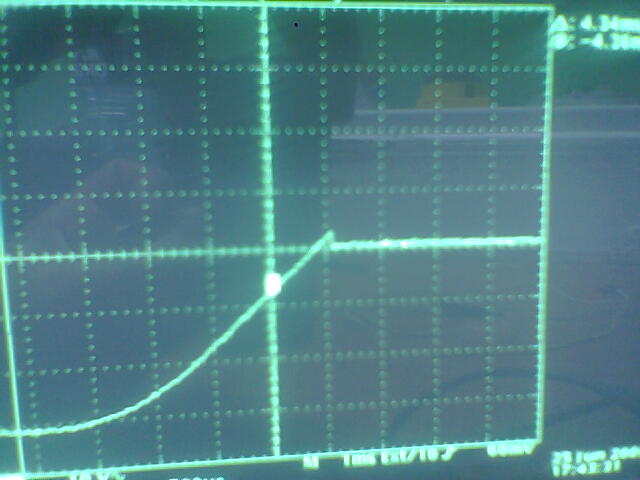

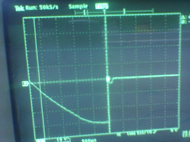

By the way, here is the difference between using zero cross and not using it.
I wonder, what is that little negative hill in the "without zero cross" picture?
Where could it come from?
Each square is 10V, and the probe attenuates the light bulb voltage by 10x, so I guess the hill's peak is around -20Vpeak.

Hmmm... that little hill could be some artifact you get from the fast switching, which is what you want to eliminate with zero-crossing in the first place :)
Cool pics. Thanks for sharing.
