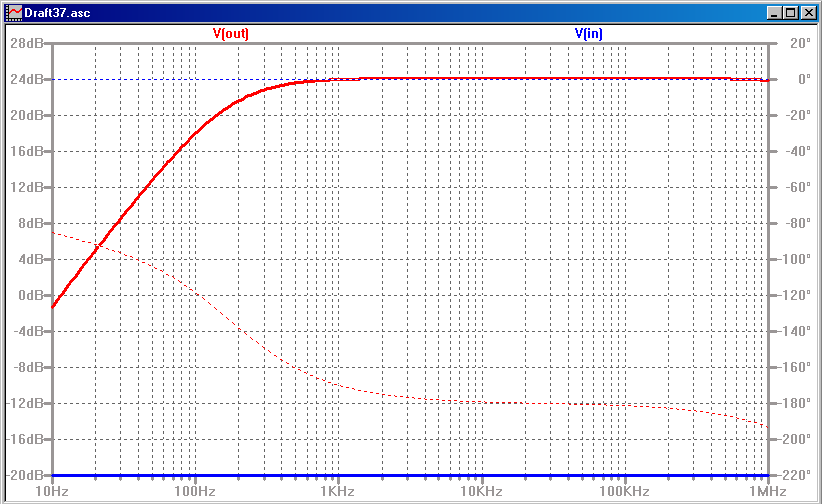

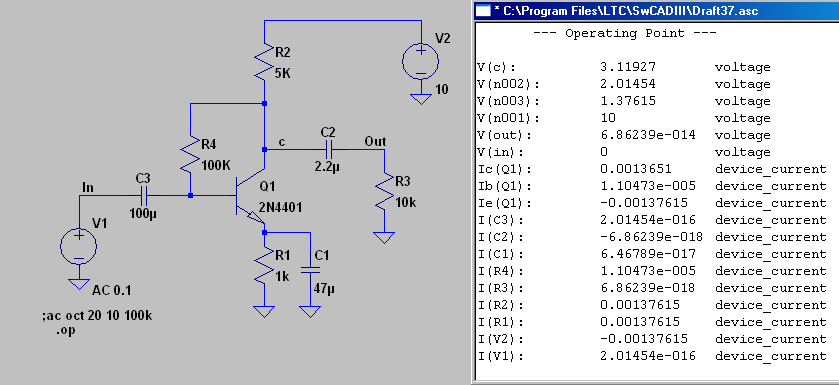

i have to design an audio amplifier using BJT transistor.
the required gain is around 55db.
i got this circuit
but am not sure how to calculate the components values, i hope some one can help me with that .
Hard to get that much gain from a single stage. This one gets ~44dB.

how did u get the values is there a program or site show you how to do it ? and if you can pls give me an example of a circuit that can get 55db
also what is the name of the simulator you use?
thanx alot
I learned how to bias an simple transistor amplifier and how to calculate an RC time constant as an EE undergrad in 1967 :D A good text book like the Art of Electronics will have the design proceedure...
To get 55 db (which is almost a gain of 600), you would need to cascade two stages, or use an opamp....
I use LTSpice (free download). Check out LTSpice User's Group on Yahoo, too.
