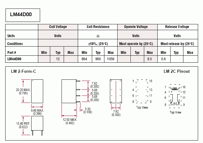

It looks like it may be a Reed Relay
LM44D00 RELAY 12V 2xPR.2A/125V 960R
Does it have a LOGO on it?
Does it look like this? **broken link removed**
Here is a General Datasheet for one. Just look down the List in the Datasheet and you will find your part Number.
http://www.srcdevices.com/pdf/EMR_src2.pdf
