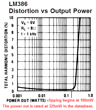

Why not just a single LM386?
The datasheet says it will deliver 700mW into 8:eek:hm:mad:9V, whould it not be unreasonable to assume it might be able to give 1W@12V?
Either way, I can see why it isn't a good idea since the THD is a bit too high so it won't sound very good.
What about the TDA7052? The maximum output at 12V isn't shown on the datasheet but there's nothing stopping you adding a voltage regulator to the supply.
Semiconductor manufacturers play the numbers game with the power ratings of amplifier ICs.
They turn up the volume way past where clipping begins to where the output is an awful-sounding square-wave with 10% distortion.
The LM386 has very low distortion up to clipping. A graph in its datasheet shows that clipping begins at an output of 180mW into 8 ohms with a 6V supply. But they rate it at 325mW!
Therefore their rating of 700mW into 8 ohms with a 9V supply calculates to only 388mW at clipping.
With a 12V supply I think the poor little IC will melt at full power. Most of the power will be heat with the speaker getting only a little.
