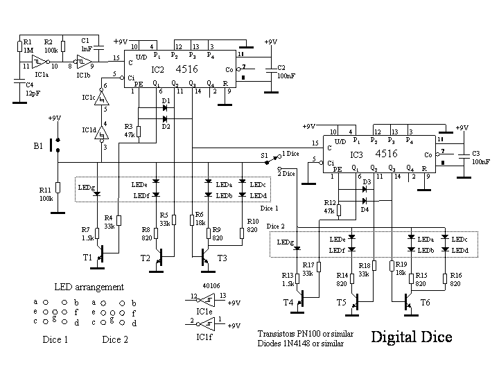

Need Ideas and schematics for digital Dice

any1 know electronics to help a girl out with
i am really stuck on my electronics project which is 2 make a matrix dice with 6 or 7 led's cud u help me pleez

Here is one that I did some time ago.
Len

If anyone cares to check the current issue of EPE (July 2005)?, it has a simple design for a digital dice - using two cheap CMOS IC's and a few diodes - you can download issues from their website at very reasonable cost!.
