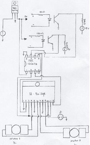

Hi everybody, I am building a line following robot but am facing a problem on the detectors since I don't know what type of infrared led and detector I must use. I searched on the net about the IR detector and LED but I found a lot of detectors some how acting as a transistor and some working as a diode…well that’s my schematic for the robot down if anyone have an experience on the line detector please assist me and thanks a lot

Your post has been up for a day or so without any responses. I cannot comment on the circuit you present without building it myself. I would suggest you try the same and see what happens.
I can add some general advice:
1) IR detection based on simply having an IRED and detector is very susceptible to noise and false signals. I would suggest that you follow the common practice of using a modulated IRED and suitable demodulation for detection . For example, the IRED can be modulated at 38 KHz, which is then sub-modulated at around 1 KHz. Packaged units are available to do the decoding. Units by Sharp and Sony are readily available in the USA at surplus dealers. I have used the Vishay TSOP321XX with good success, and the new units are not much more expensive than the older, surplus units. The TSOP is about the size of a TO-92 transistor.
2) Perform a search on this forum using the term: line follower. There are numerous other threads on the same subject.
3) The following site has good suggestions and sample code for the 12F5XX or 12C series of PICs for IR detection and obstruction avoidance:
http://users.frii.com/dlc/robotics/projects/botproj.htm
4) Last, depending on how much work and innovation you want to do and how much time you have, I recommend you visit this site:
http://www.navfltsm.addr.com/ndb-nav-history.htm
The “four-course radio range” was used for aircraft navigation until the mid-1950's. One could make an analogy between that method and a line follower. For example, the left IRED could transmit one code, and the right IRED could transmit another code. When exactly on the line, the codes would mix, and hypothetically, an error signal proportional to the deviation from the line could be calculated. The biggest problem I can see at the outset would be to get a line that reflected IR a lot better than the background. Since I have never tried any such thing, I have no suggestions to give you, but it seems to me that any line follower based on IR will have to solve that same problem to some extent.
Good luck. John
take a look at the qrb1134 https://www.electro-tech-online.com/custompdfs/2006/10/QRB113x.pdf
it does a decent job, has a built in shield and a daylight filter. junun.org sells them for $1.50 but others carry them too. I have several bots that use them and they work fairly well.
yes, you can build your own for much cheaper but note that there are lots of issues about shielding since it has to work via reflections. the '1134 is pretty well designed so you might want to borrow from it's design.
on your circuit. I think you want more than 2 sensors. with just 2 your bot will wander back and forth - how will it know where it is over the line. I suggest at least 3 sensors and many good line followers use 4 or 5. code complexity runs from very simple up to very sophisticated. I'd start by doing a state diagram for the sensor values.

think about how you use 2. If the left sees a line, turn right and if the right sees a line, turn left. that leads to a zig-zag path and much slower running time. If you had 4 equally spaced across the front of the bot, you would turn less if you saw a line with the inner sensors and thus run a straighter and faster line.
Have a look at This line follower. It uses 5 sensors and has a very good explanation of how they work and a circuit diagram. There is also video of it running with just Proportional control and then with Proportional and Differential control. Very informative.
