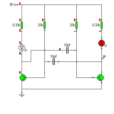

Can anyone provide me w/ the light flasher circuit that is in the back of the book "Getting started in electronics", by Forest M. Mimms, I think that's his name. I'm away from that book right now, and I really need that circuit.

Thx, but I need the circuit that has two transistors. I've seen two transistor circuits, but they have diodes in them, and as i mentioned, i'm away from home (where all my diodes are). I can't use any ic's. I'm going to make this circuit to test a capacitor actually.
Is this what you are looking for?

Phasor's circuit really needs diodes between the emitters and gnd in order to prevent the transistors going into avalanche breakdown during the off periods. This won't do any obvious damage to the transistors, but may degrade their gain.

Another alternative is to use a supply voltage that is less than the B-E breakdown voltage. Five volts will work for some transistors (e.g. 2N3904).

Transistors commonly go S/C under these conditions, it's crucial to include the diodes to protect the BE junction.

Nigel is right. In the multivibrator circuit shown, it is likely that there will be sufficient energy stored in the capacitors to damage the BE junction.
The transistors would not be damaged with small capacitors, but my understanding is that their gain would be reduced.

The circuit showed 10uF, which I would expect to be high enough.

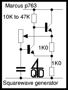

Ok, point taken re B-E junction. This one also not mimms, but perhaps it will suffice? From 4QD site. They have quite a few other astable designs there, take a look if you're interested.
(I know it doesn't show a flashing light, but you could add it with not much modification)
