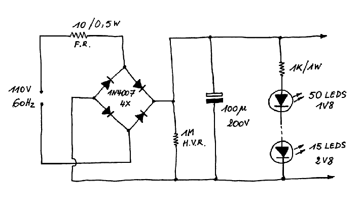

hello y'all, can anyone help me. plain and simply i am over my head. i need a couple of LED circuits. both will plug into 110 house current. they are for the purpose of growing plants out of season and indoors. first circuit is the red LEDs about 250 or so, final # adjusted to simplicity of circuit. diode forward voltage -1.8, diode forward current - 20mA. second circuit is the blue, final # of LEDs about 65 or so, adjust for simplicity of circuit. diode forward volts 2.8, diode forward current 20mA. i have tried to figure these out for myself, but due to my lack of knowledge i don't feel my own circuit would be safe. can anyone help me out ?? thanks

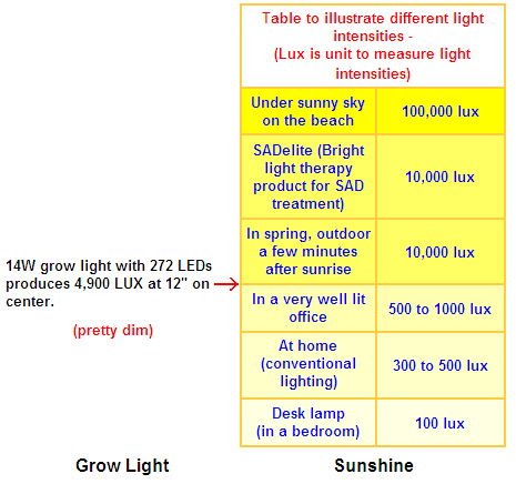

The LED grow lights kit has 272 LEDs (!) and lights only 1 square foot.
They give a number for the amount of LUX it produces but don't say how many LUX plants need.
I wonder how many LUX come from the sun in summer?
I looked in Google for Sunshine LUX and found out that the LED grow light has a light intensity that is only 4.9% of sunshine.

Here's a circuit designed for five rows of 65 leds.
Start with one row and measure the voltage drop accross the 1K
resistor. Later you can add four more rows to complete the circuit.
Mind the polarity of the 100 µF capacitor, the diodes and the leds.
The 10 :ohm: resistor is a fusible resistor, the 1 M is a high voltage
resistor.

'lo again, y'all, on1aag, thanks pal !! looks what I need!! any chance you can draw it out as i would plug it into my breadboard, did mention i don't know jack about, but i can plug stuff in. on1aag, if i can repay you anyway, let me know. would you like me to get you a deal on lobsters, i'm in maine and lots of folks like that.
