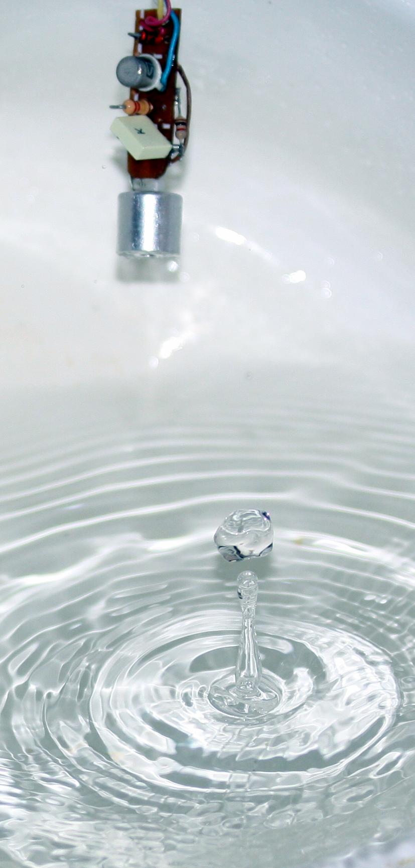

hello,
I need to trigger a camera using the sound made by the splash of a drop of water. The sound is picked up using a electret mic placed at about 20-30 cm from the sound source.
The best i could think of is posted here https://www.electro-tech-online.com/threads/canon-450d-remote-control.99225/ but with this design i have to place the mic too close at about 2 cm from the sound source
I also need to adjust the level at witch the camera is triggered (for popping balloons or water drops).
Can anyone help me to achieve this?
PS: I've uploaded two picture with the results I've got so far

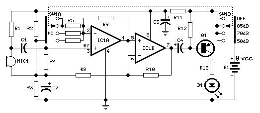

This is a sound level indicator, I don't know if it will work, I've made that and at the lowest level it is sensitive, but I don't know if it will be for you, maybe the sound of a drop of water is not very loud for it to detect it, but you can vary the resistors to very low values or maybe you can add another Op. Amp, but that is only a guess 'cause I haven't studied them, i'm sorry it is in spanish, but they areonly a few words.
The LED will lit when the sound level is reached.

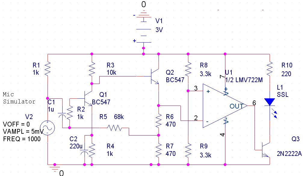

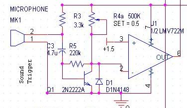

Are you using the Cmos LMV722 dual opamp?
The circuit will not work with many ordinary opamps.
The Cmos opamp has a gain of about 4000 which is more than enough. But the transistor that feeds it is saturated because the trimpot is not set correctly for it to be an amplifier. The trimpot needs to be set to about 1.4k which is impossible with a 500k trimpot. Try a 5k trimpot instead and adjust it near one end so that faint background sounds trigger the circuit.
Or remove the transistor that is not biased correctly.
You might as well remove the diode that does nothing in this circuit.
yes, I'm using lmv722m as a comparator

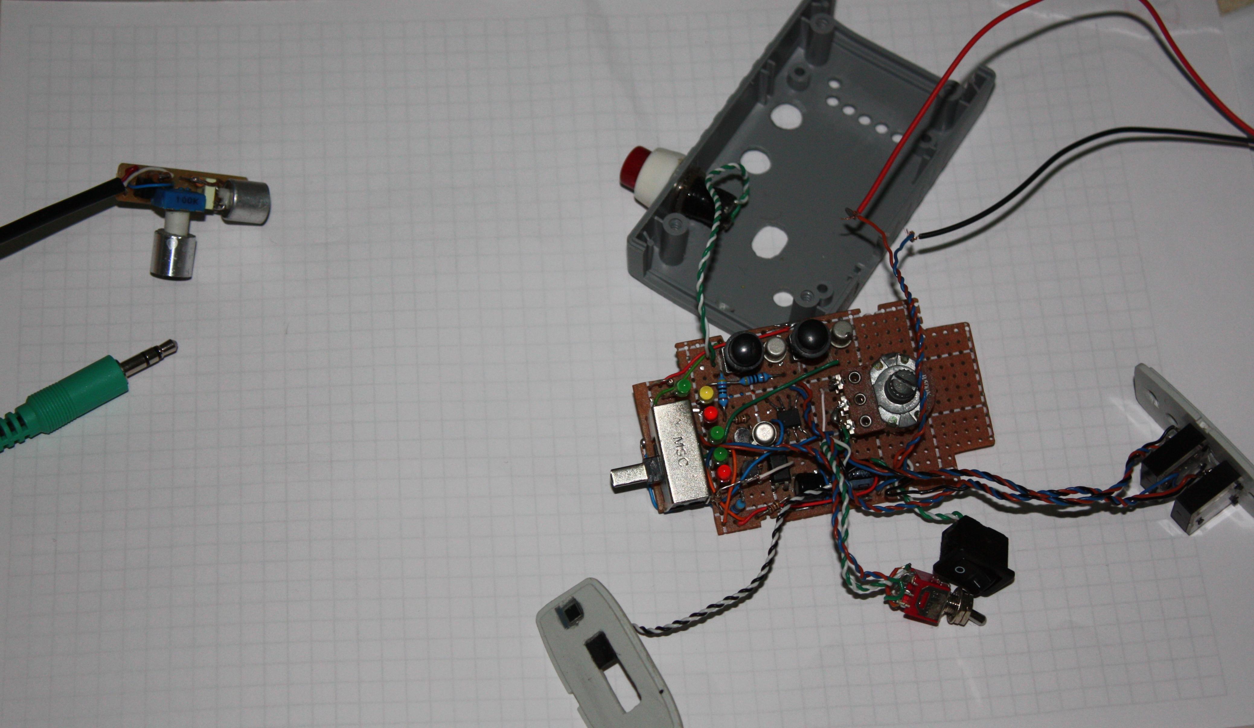

unfortunately i disassemble that mic circuit

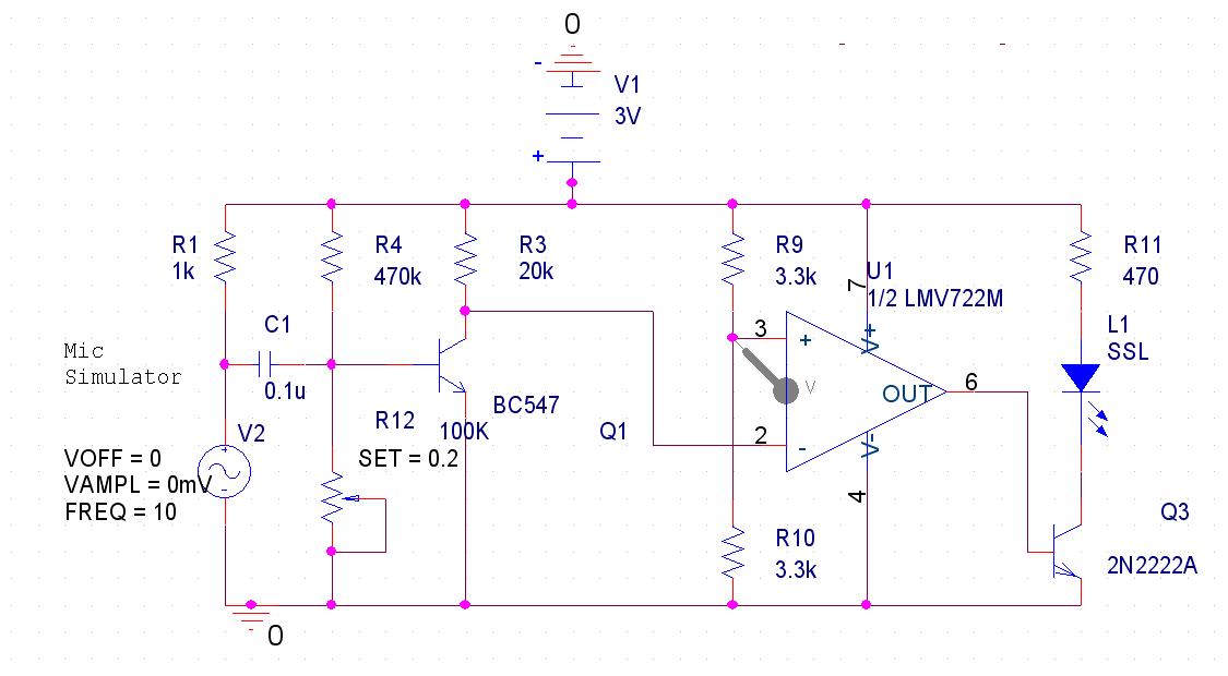

now I'm using this one but it actually is worst that the one before
PS: The 1n4148 i forgot to delete it from the simulation circuit, i didn't use it in the circuit

do you think it is ok to remove the transistor?
Because i forgot to mention that between the op amp and the transistor circuit i use a stereo cable about 1m long
If the 100k trimpot is set to about 105k (plus and minus depending on the gain of the transistor) then the circuit will be very sensitive. But since the transistor does not have any DC negative feedback then it is also sensitive to temperature changes.
The transistor will also amplify changes in the supply voltage.
I was taught that such a simple transistor circuit should never be used for anything.
Thanks again for replaying Audioguru,
I've change the pot with one of 10k + ore 10k resistor in parallel(i don't have a 5k right now) and the result was almost the same in sensitivity..so i change the 2n2222 with a bc547 (measured gain is 650) and the sensitivity has increase a little bit. Maybe the mic is not sensitive enough - i think is a Velleman with a sensitivity around -68dB and a nominal voltage of 4.5V - next week i will receive a new mic BCM-9767P from BE-STAR -44±2dB (VS=3V/RL=2,2kΩ) i hope that will do the job.
Do you think is a good idea to remove the transistor near the mic as i connect the mic preamp with lmv722 input with a stereo shielded cable about 1m long?
You need to learn about transistors to see that yours were designed completely wrong.
If you bias the opamp properly and use negative feedback then it should work fine without a transistor. But that opamp has a much lower max gain than normal opamps.
I don't know if the very short sound duration is enough to trigger your camera.
