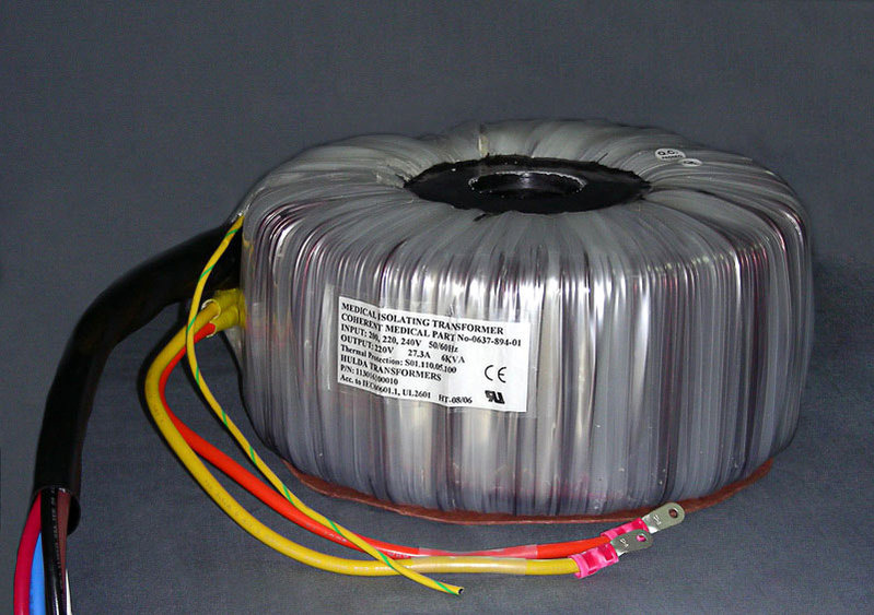

Toroids are commonly used as power inductors, there are toroidal transformers though, personally I've never seen one except for some small RF baluns. But their shape concentrates the magnetic flux better than any other shape excluding a pot form, which is basically just a toroid with a case around it.
That surprises me that you've never seen a toroidal transformer before. Here's a picture.
I don't take apart many medical devices Hero =)
