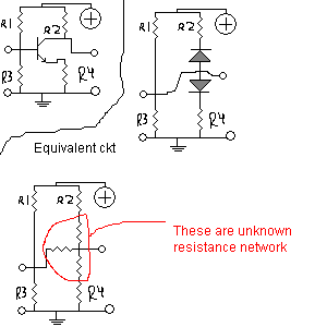

Not so Fast
Guys here is an attachment in which I shows the eq. ckt of the Ce amp circuit. The unknown resistnace network cant be solved with out finding the total current or the total resistance. How you find Total current or resistance. Can you tell me?. Used some sort of circuit solving software like Circuit maker or some others :twisted:
it is Impossssssssssssssible to solve such unknown branch ckt :oops: .
Re: Not so Fast
u need to have a look at H-parameter analysis of Transistors.
