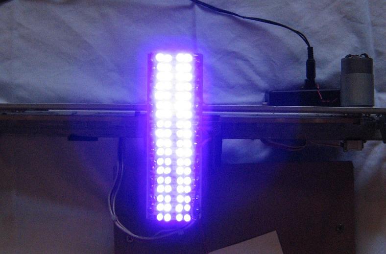

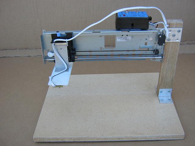

I have used UV leds for years now and have them attached to the carriage out of an old bubble jet printer to make a scanning system so as to keep the number of leds required to a minimum.
I also done a how to build a UV led scanner on a different forum.
I used led clusters and found it cheaper and easier than using single leds.
As the clusters come in blocks of 8 leds but have a gap between 2 blocks of 4 i needed to stack them side by side, this gives 4 leds in a row.
Each cluster is rated at 12 volt.
Here is a few photos of what i use.
Pete.

The led clusters were bought off ebay, so would expect you could also get them.
Yes the leds need to be close, and the reason i have the leds mounted about 125mm above the circuit board is so each led light spot overlaps with the other next to it or you will get uneven exposure across the circuit board.
They are a standard ultra bright led with a narrow lense (15-20 degree lense i think)
The best thing you can do is get the UV light side setup good and then making boards is just so easy afterwards.

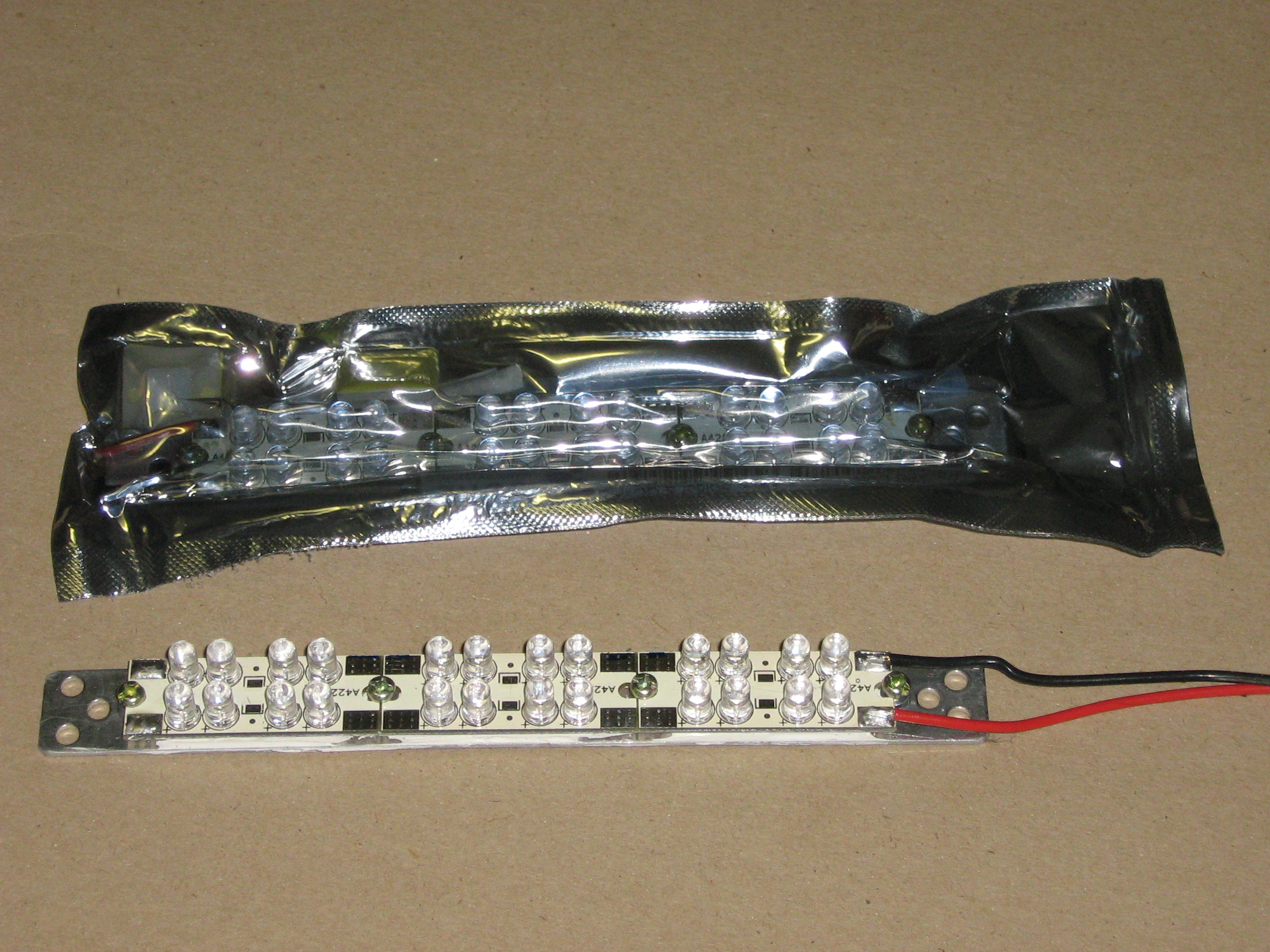

If you want a ebay link to led clusters i will try to find one.
OK clusters here.........
Pete.
Nice setup SABorn, I especially like the addition of the scanner to sweep the light. I've always wondered if LED hotspots would cause a problem with exposure. You could probably do one better and make the bar spin in place =)
I do 100's of boards a year with this crap setup made from junk, and every board comes out perfect.
Its just a matter of getting the led light spots to overlap slightly.
Half the fun is making the scanner, and then smileing at the results you get everytime so easy.
It dont need to be pretty to work well.
Pete.
Form follows function, making it pretty won't help it work. Although I think I would like some kind of support on the far end just on general principals. Seeing open ended arms always bothers me. =) Mind you the arm that's anchored looks like it could be hit by a baseball bat and still stay in place, even some chintzy piece of doweling to reduce the possible leverage on the load bearing arm, the extra support could be used to hold the exposure plate in place.
No need for extra support as its solid enough, and only needs to hold the weight of the leds, your mothers chooks could roost on it and it wont move. :D
I just place the pcb on the base board with the paper artwork on top and a sheet of plain old glass on top to hold it flat...........works well for me.
Keep it simple, and it will work well, as long as the height dont change and the exposure time remains the same everything will work out everytime.

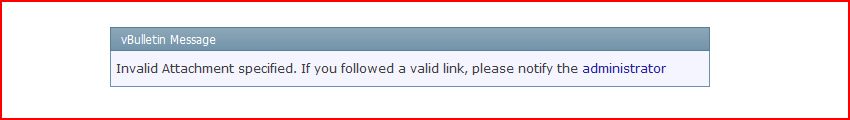

Ok i'll try to upload another one. Don't know why it didn't work in the first place because i clicked on the insert image button, strange!**broken link removed**

Your link is still broken as i get this when i click it.............

Pete, i've already notify the administrator about the problem with the uploads. Maybe you can tell me what exactly you do when you upload your pic's. While i'm online i'm able to open the pic's, but when i log out and on again it seems not to work. Where do i look for the admin. reply. I'm still new here and this forum is working completely different from others, so i'm kind of lost here

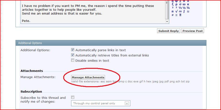

Hi Soda,
With adding photos, just scroll down below the box you type a message in and you should see a "Manage Attachments" button ...click that...then click browse ...find your file of the photo on your computer, ...then click upload.....Close the upload window.
The photo will show up in the post when its submitted.
I have no problem if you want to PM me, the reason i spend the time putting these articles together is to help people like yourself.
Send me an email address is that is easier for you.

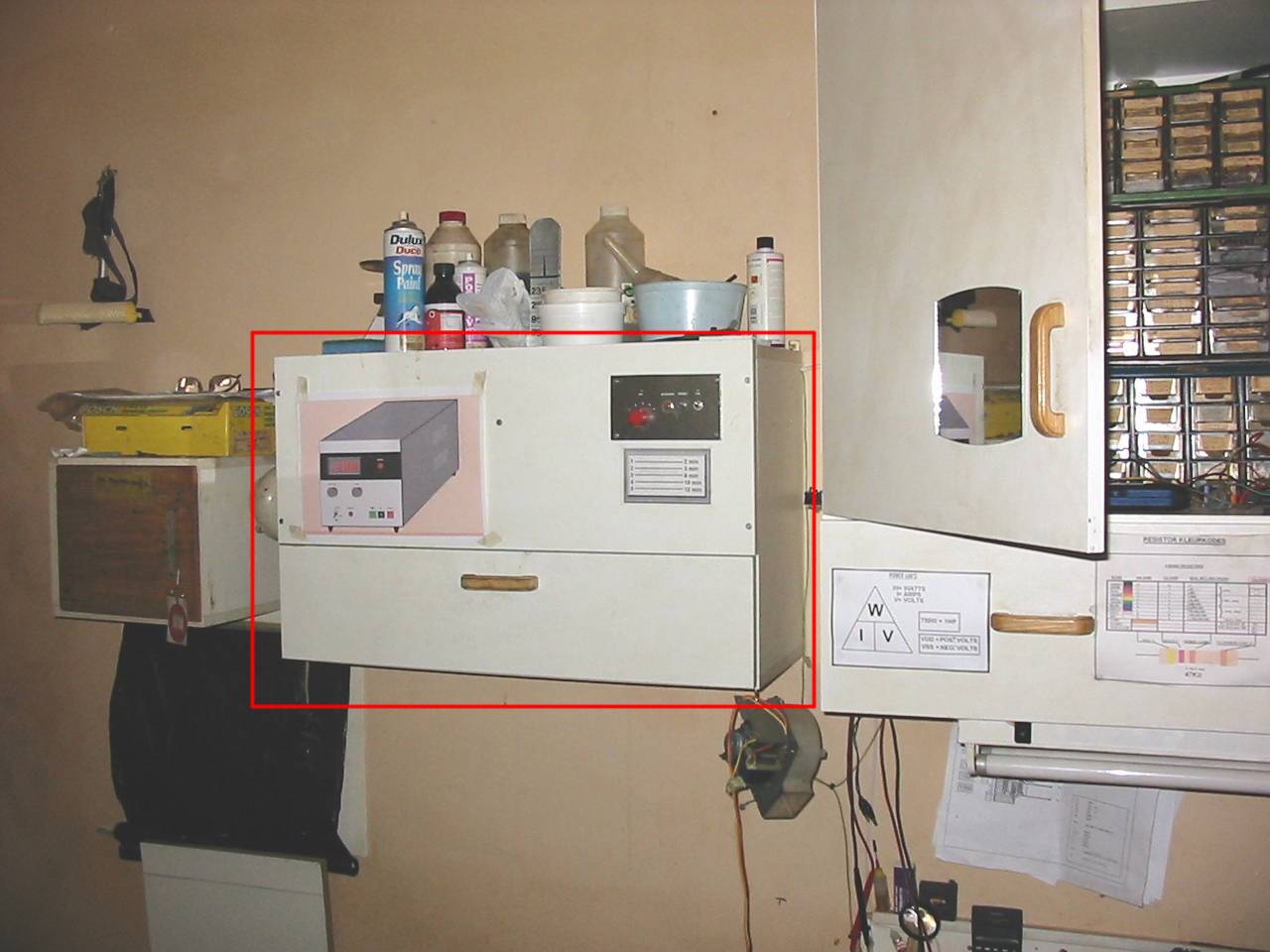

Ok Pete, this is going to be my last try. If it's not working then i send my email ad with a PM. About the oil thing, i applied it with a kitchen sponge and it was working gr8, so from now on the oil is in and the transp is out, for sure. I've red all those page i've d/loaded and came up with a plan (plan z)Ha, Ha. I still have a old scanner. I'm going to fit the led's on the part which hold the cold c tube.You said 2 rows with say 20 or 30 in each row would be ok. This means i don't have to use 560 led's.The only led's thats available to me are those with peak wave length of 410nm.If this is not ok, then i have to have a look at ebay

Well done the picture worked.:)
I must say the tidyness of you workshop puts me to shame, mine has about 10 projects deep on the bench, and crap eveywhere. :eek:
The scanner will work if you can figure out a way to drive it slow enough and do enough passes, BUT... remember you need to have 100-150mm gap between the leds and the circuit board as to allow the led light spots to overlap evenly or you will get strips in your exposure.
The first one i built just used 2 rows of single leds, but this required more passes to get good exposure than the one with 4 rows of leds.
The 2 rows of leds was staggered so the second row was in the gap between to leds of the first row.
The whole thing is just about anything will work and its all about how you set it up and allow enough time/passes to expose the board.
I build a lot of stuff from recycled crap and its cheap and effective, plus a lot of fun re-engineering something.
