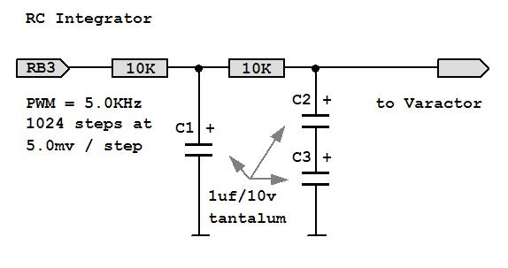

May I ask if the RC Integrator I've used in the past (below) is the same as the filter you're describing? I used this circuit to develop a pretty precise analog voltage in 1024 5.0-mv steps from the PIC 10-bit 5-khz PWM output...
I understand that the PWM frequency determines what value capacitors to use... Is this correct?
Regards, Mike

Yes it is, although that's a double one, commonly used for varactor tuning, where you need exceedingly low ripple.
Along with the resistor values yes, it's basically a low-pass filter.
To answer 'jrz126' as well, the MicroChip link I posted earlier gives the calculations required.
