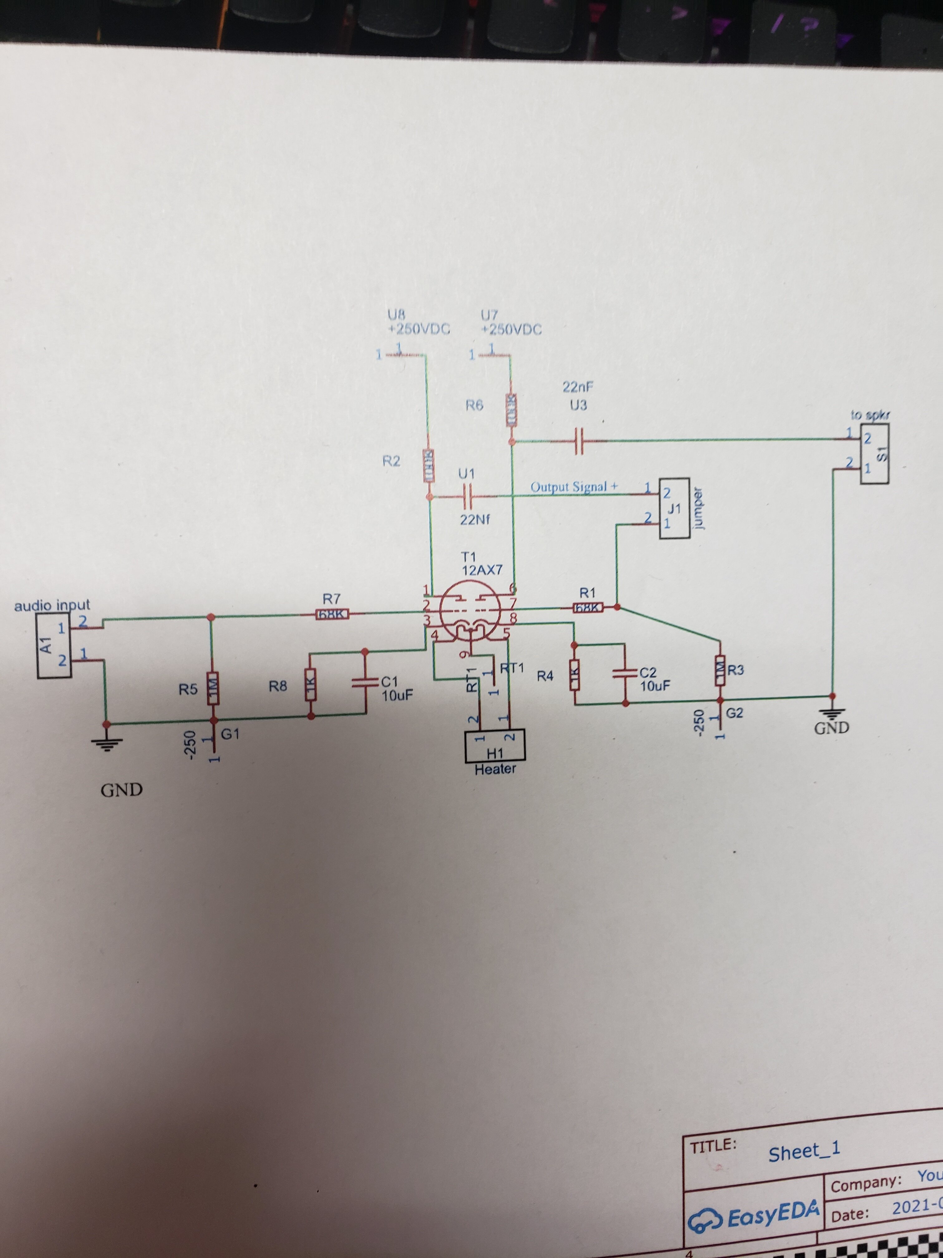

So I'm working on the tube amplifier project again with a 12ax7a tube and I made this schematic. Does everything look the way it should for a single tube amplifier? (I know I left out the volume pot for the second half of the tube.) Just asking before I have it made into a pcb. Thanks in advance -Ray

A speaker has a low resistance and needs a fairly high current.
But your vacuum tube circuit is 70 years old and can drive a high resistance with a low current but cannot drive a speaker, but it might be able to drive a power amplifier.
Calculating that if the input impedance of a power amplifier is 10k ohms then the 22nF output capacitors of your circuit will reduce sound frequencies lower than 730Hz. No mid-bass and no deep bass.

So, could I use a high impedance set of headphones or a high impedance speaker and if so what impedance would be suitable?

Many years ago, vacuum tube amplifiers used a huge, heavy and expensive output transformer to match the high impedance of vacuum power tubes to low impedance speakers.

Ok, how would I go about figuring out the transformer to use to match a speaker to the output?
Would something like this be better than my circuit? I've noticed on this circuit they feed the audio signal into both grids at the same time; on my circuit I feed the audio signal into one side of the tube and then reamplify it through the other half of the tube. This also doesn't need to be a very powerful amplifier; just around 1/4 watts.
There are hundreds of valve circuits out there - use one of those, rather than randomly connecting a pile of parts and hoping it might somehow work (it won't).
Valve output transformers are freely available still, even RS Components sell them.
You also don't use a 12AX7 to feed a speaker transformer, it's a preamp valve - you need a power valve, such as an EL84. For your specific application I would suggest using a triode/pentode, such as the ECL82 or ECL86.

With this circuit, should I build a preamp with the 12ax7 tube or will this be sufficient by itself?

It's already got a preamp - the first half (triode) of the valve.
I would also suggest a somewhat better power supply, with a proper isolated transformer - but back in those ancient days it was fairly common to have live chassis's to save money.
