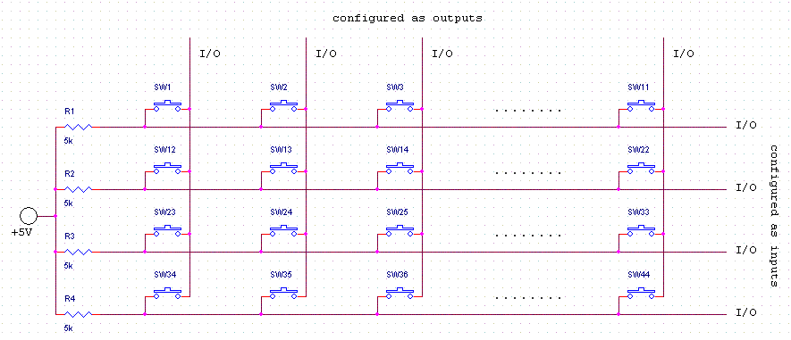

My final year project involves using a PIC16F876A to check the statuses of 44 switches which are connected in a matrix. (see attached picture)
The program is similar to interfacing a keypad to a PIC. The columns (top) are configured as outputs, while the rows (side) are configured as input. When the switch is not depressed, the PIC reads a logic high on that switch location (row,column). When it is depressed, the PIC reads a low.
Here's my problem:
With 1 switch depressed, the PIC successfully reads the switch status correctly which is logic low. When I measured the voltage when that particular switch was scanned, it was in the millivolts range.
With more than 1, or all, of the switches in the same column depressed, the PIC still successfully reads the switch status correctly.
A problem arises when more than 2 switches in the same row are depressed, the PIC reads logic high instead of logic low. When I checked the voltage level, I measured 2 volts!
It seems that the PIC gave an output of 2 volts (which is supposed to be 0) to the columns (output) and it reads the 2 volts on the rows (input).
Can anyone help me? For normal operation, the switches are depressed, so the PIC should read logic low on all the switches.
Do I need a buffer/driver for the output of the PIC?

It's because the other PIC outputs are set high, so when you press more than one button you short a high output (or up to three high outputs) to a low output - not a good thing to do!.
To cure the problem, you could fit blocking diodes in the output leads, cathodes to the PIC, anodes to the switches - this will prevent the PIC pulling the switches high.
One easy way is to put diodes in series with each switch to prevent them from interacting.
Another way is to configure the active (low) column I/O line as output while configuring all other I/O lines as input. You can easily do this by manipulating the TRIS register instead of the PORT register. This will prevent two or more switches in the same row from interacting. However this will not prevent three switches from interacting when a switch shares both row and column line with the other two.

could you guys post a diagram? i'm not sure i understand the connections.

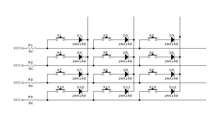

As motion suggested, you could put a diode in series with every switch, but that's a lot of diodes (although it is common practice). Using one diode per output line means less diodes, see the attached small section of diagram. As he also suggested, you could set the TRIS register as you scan the switches to make the unused ones inputs.
44 diodes for 44 switches.
BTW, PC keyboards with 100+ keys don't use diodes and still you can use CTRL+ALT+DEL keys.
