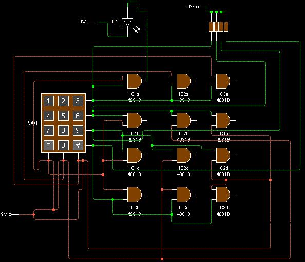

On my current circuit (its a electronic poker chip device) currently the inputs are PTM which send out pulses, however, I would instead like to give the option for the user to input the amount they want with a key pad - its the 3 x 4 one from RapidOnline. However, I have no idea on how to code the E28 chip to work with it - how would you go about coding it??

I have attached a picture of the wiring of the keypad I wired up, however, each row, when pressed i.e. for the first row with the LED. When either 1, 2 or 3 is pressed it lights up the LED even though its only meant to be 1....

Well all your columns are at 9V, that won't work with a matrix keypad you have to scan the columns. What's with the logic gates?
Anyway the right way to do it requires 8 I/O pins and some pullups on the input lines. The lazy (and old fashioned way) is a MM74C922 if you can find one.

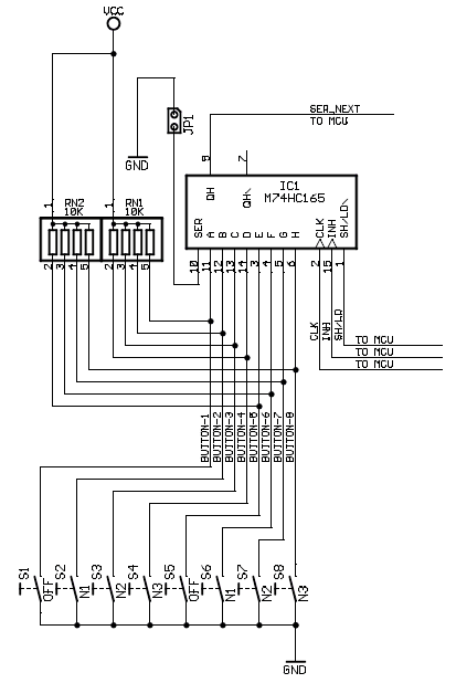

if you don't have to use a matrix coded keypad you might use individual keys connected to a parallel in - serial out shift register M74HC165.
Connect the serial output to the MCU (or to the next stage) and write the software accordingly.
Cascading chips you might connect an (almost) unlimited number of keys (buttons).
Boncuk
P.S. the jumper sets the first serial in pin to low.
