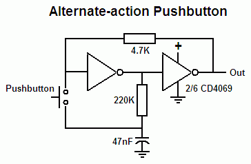

Debouncing the switch is easy, just use a resistor in line with the switch and a capacitor to ground, it forms a low pass filter. Do you really need a schmitt trigger?
ljcox said:
You can't do it with a dual inverter. You need a Flip Flop and bounce suppression.
yes, you can do it with two inverters. Find the original post.

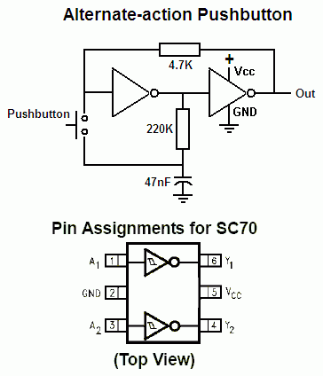

The goal of this project is to keep it as small as humanly possible.
The tactile switch I have now is a SPST MOMENTARY. This is the core of my problem because I could not find a switch that size that works as a normal SPST.
I want the LED to turn on with a single press of the button, and off with another press. Right now the LED simply stays on unless I physically hold the button in.
As a solution to this, it was said that I could use this Dual-Inverter (pictured above in my first post and here is the data sheet - https://www.fairchildsemi.com/ds/NC/NC7WZ14.pdf )
So now I think I have all my components (as seen in the above picture). At this point my problem is wiring. I have no idea where the Dual-Inverter goes or what leads to solder where!
Again, I apologize for the confusion and I hope that someone can help me put this all together now.
The circuit is simple to wire.
Pick one of the inverters and use its pins numbers for the first inverter in the circuit. Then use the other inverter's pins numbers for the second inverter in the circuit.
Something is wrong
Okay, I wired everything together but it still works like a momentary switch.
Maybe I did something wrong so here is what my circuit looks like.
Your wiring is missing two important resistors and an important capacitor.
Your battery is shown connected to the wrong place in the circuit and with its polarity backwards.
The IC is shown without a power supply.
The recommended inverters IC has an absolute max supply voltage of 7V then your 12v battery is blowing up it and the LED.

As mentioned above, I am a noob when it comes to electronics, but there’s no need to be a jerk about it. Everyone else has posted some very useful information and then you, a ‘Super Moderator’ come along and offer nothing but sarcasm.
Thank you for your help Audioguru, and thank you for the tip Hero999. I’m just going to have to find another solution because adding two resistors and a capacitor makes this project too large for my needs.
yeah... I was trying out Proteus ISIS demo to make the circuit diagram. First time using the program as well as the first time I have ever made a circuit diagram and I didn't know much about how to use it (such as how to change the voltage, but after playing with it more I figured it out).
I'm actually using two 1.5v button cell batteries.
Unless the LED is very dim with a low current, Two button cells will power it for only a few minutes. Two AAAA cells will power it for 31 hours, two AAA cells will power it for 62 hours and two AA cells will power it for 143 hours.
