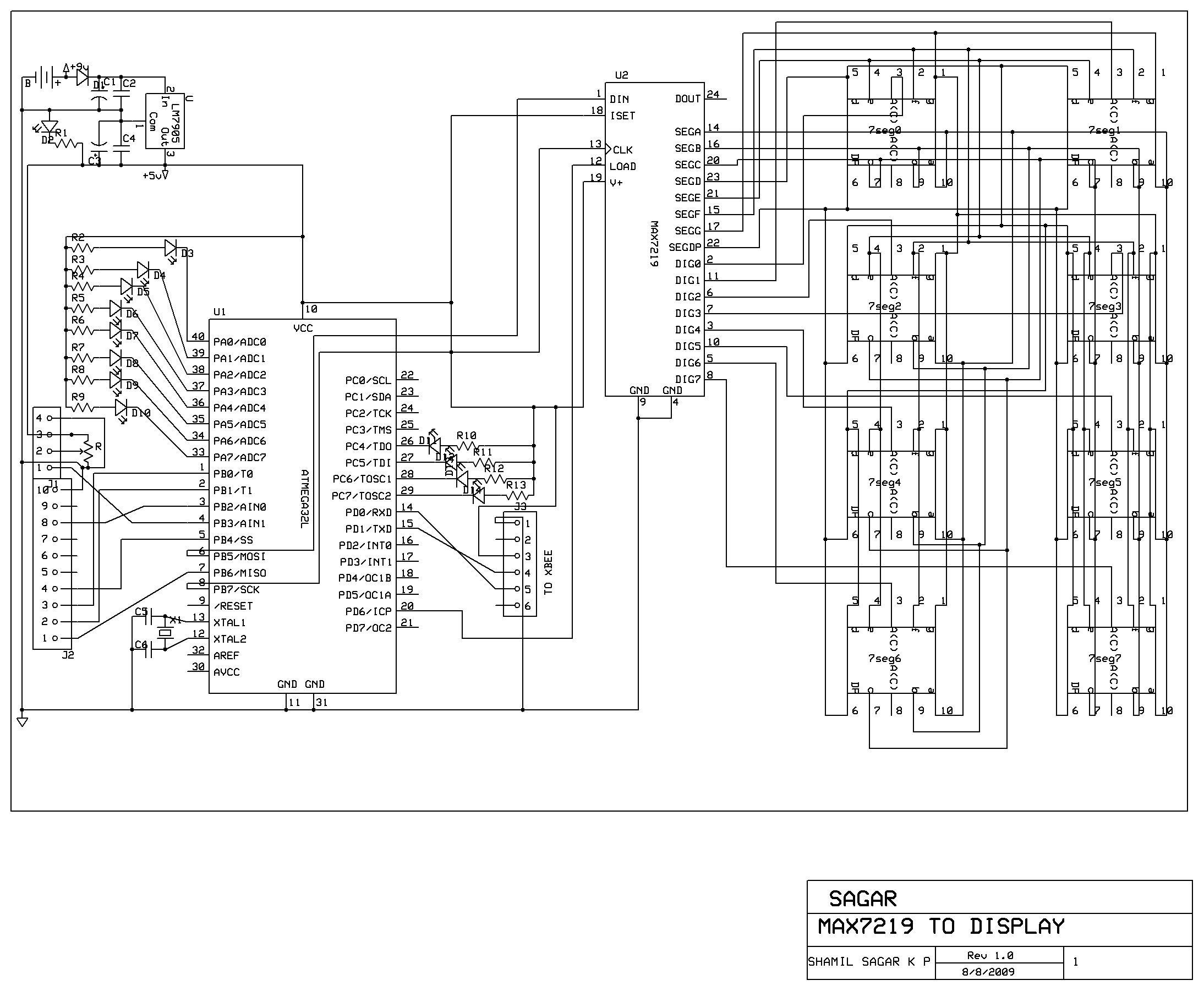

hi all,
i am uploading the schematic of my project.i need someone to check for errors and need advice also....thanking you in advance..
Sorry - the schematic seems to be invisible and therefore hard to check !
i am sorry...forgot to upload...
The obvious error I can see is that SCK is connected to 5V. Look where they cross.
The LED D2 [ power indicator] is reveresed.
those two corrected...any other errors?and how do i post a .pcb file here?

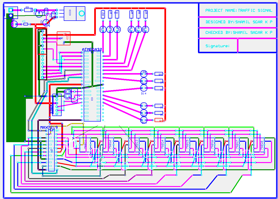

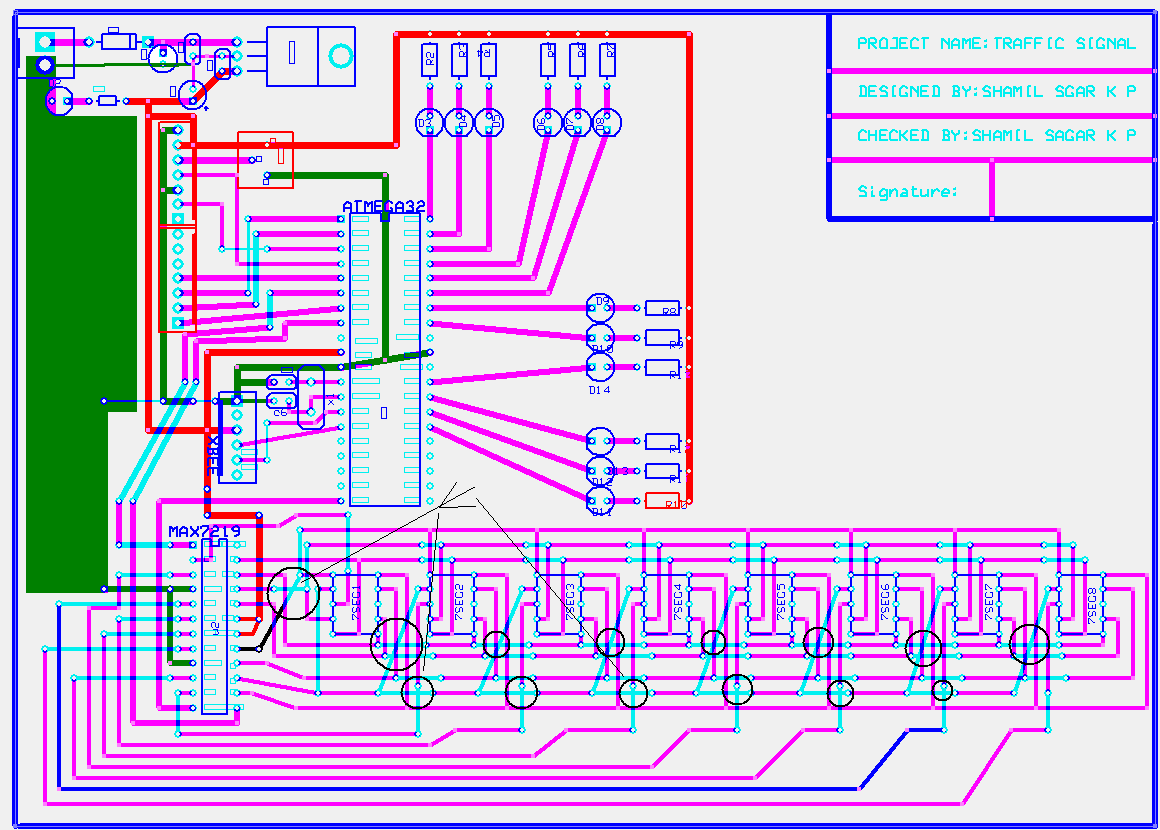

i have made the pcb by using expresspcb.check for errors in this also...
Checking the pcb artwork,, some errors are circled, correct it and repost.:)

Because you are switching LED's I would increase the value of C3 capacitor, what is its present value.?
Also add a 100nF decoupling capacitor close to the MCU on its power pins. pins 10 and 11

value of c3 now is 100uf.should i change it?
i have put a capacitor between 10 and 11 of mcu.
i am not familier with max7219.is there anything else i will have to include on the max7219 part?please check that part and let me know...thank you...

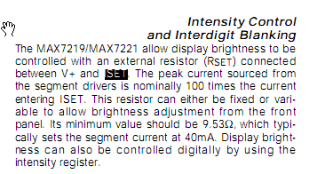

The value of Iset for thr MAX7219 requires a resistor from +V to Iset.
Look at this image.

You should now recheck your artwork against the circuit diagram and datasheets.
I have carried out a careful check, but I will not be held responsible for any errors that may occur.
