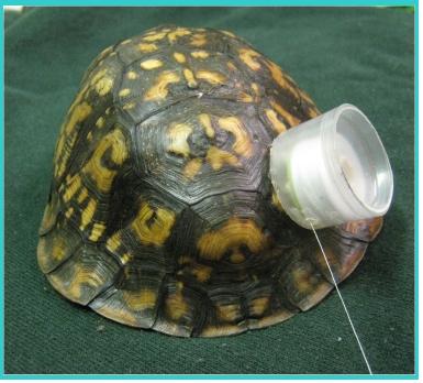

I use single transistor, crystal controlled transmitters in my Box turtle research, but don't know if I am getting the most from my design. Here is my radio page on my research web site. **broken link removed**

Looking at your website, at one point you comment that you are using antennas which are 5 inches long, this is likely the biggest loss of efficiency in the system.
Also in the website there is a schematic showing a transmitter with a 12 inch antenna and a 12 inch counterpoise, this will be much better, but 12 inches is still an bit short for 150MHz.
If you could make the antenna and counterpoise 18 inches long, that would be about optimum for 150MHz. But I guess that may be a bit big for the turtle!
Make the antenna as long as possible, and use a counterpoise.
Adding a counterpoise to a transmitter with a short 5inch antenna will give an improvement, probably more than fiddling with L and C values.
