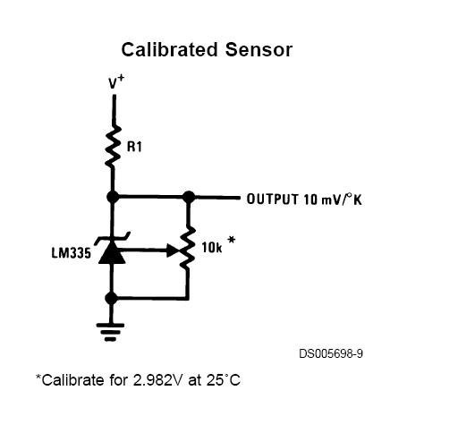

i need to add temperature display , i have a bunch of LM335 i bought a

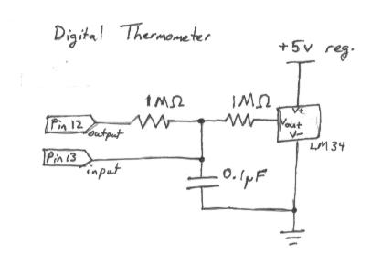

i hve a schematic that i downloaded from the internet ,dose this one work???, (i know it use LM34).

i am not understanding what you are outputting ..
you only need to read analog from the device..
thats a shcematic from somebody was using this interface with a 16F628 and a LCD i dont know if it works or not ...thats why iam asking if it works like that .
i think the output is for (V) refrance.
iam going to use your schematic with LM335
in my project .
is it going to be ok to use the VDD for refrence for the scale that i need?

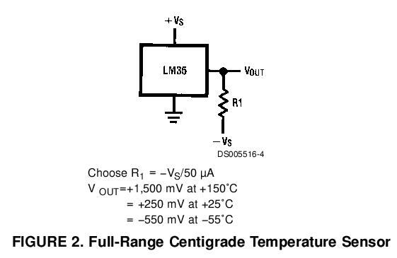

Sorry for butting in, on your thread prosound90. I am working on a similar req. for my project and was planning to use an LM35.
On the datashet the circuit below gives full range -55C to +150C
Could I confirm:
> If V+ is 5V V- is ground R1 should be 1K Ohms? ( -V == -5V? :oops:)
> I could hook up Vout directly to ADC pin on 16f877?
Spiros
in my project .
so V+/.005
or your V+/.004 =R1..
might as well not bring I to the max..
even 1 mA would work great ..
Could I confirm:
Spiros
do you have -5V available ..if not, dont use a resistor..
if you do , -5/50 microamps = 10K ohms..
i dont think yours needs a resistor for 2 centegrade to 150 C..
but to get the full range they recommend..>
Choose R1 = −VS/50 µA
V OUT=+1,500 mV at +150°C
= +250 mV at +25°C
= −550 mV at −55°C
i dont see why not..

Thank you for your reply williB.
I need the negative temps so I have to try and use the full range.
williB said:
do you have -5V available ..if not, dont use a resistor.. if you do , -5/50 microamps = 10K ohms..
I do not have -5V available, so I presume I can not use that circuit.

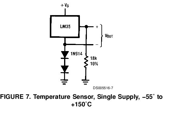

The datasheet also has this circuit .... the -ve output voltage confuses me. How would I use that circuit with a pic?
Spiros

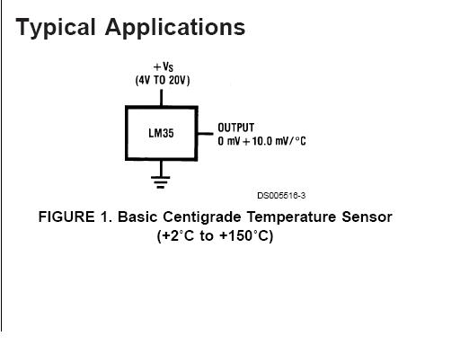

im curious about this, if the LM35 is placed in a freezer, will the voltage output immediately drop to 0 V?
Im having a strange problem, no matter where i place my LM35 the temperature range is always between 25 C to 35 C.
I grounded my -Vs in this case, since i dont require any negative voltage
where did you ground the LM35..??which picture?
