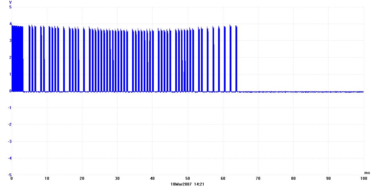

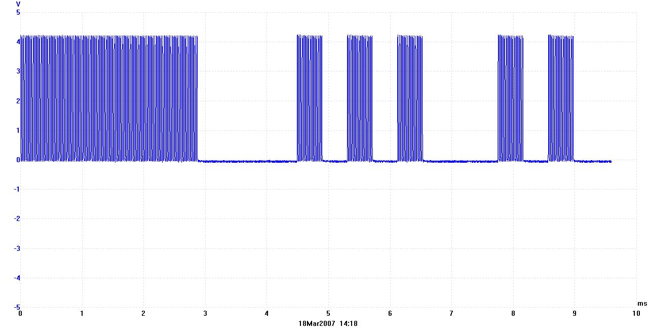

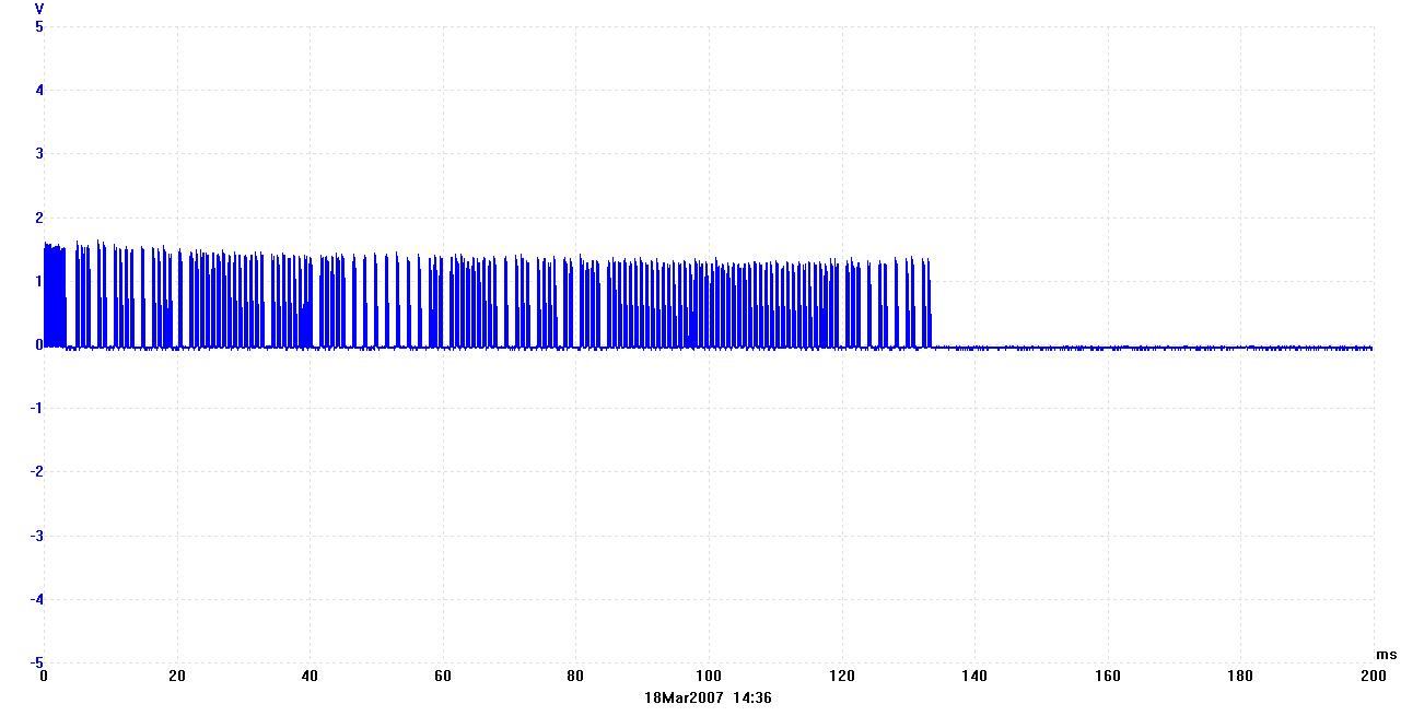

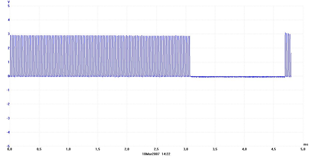

I have just been able to see that the signal is really modulated at 38 kHz, but I still have a hard time decoding the bit stream...
I will post some captures done with an storage oscilloscope I've managed to get a hold on, and using a phototransistor.
(The first three are an off signal at different scales, the last one is an on signal (which is longer).
Is there any simple way to decode this?

To start with, use an IR receiver IC, this outputs just the data, without the unwanted 38KHz carrier - makes it easier to see what's happening.
To try and decode it, try different buttons - in your case it obviously doesn't apply - but how I've always done it is to compare the numeric buttons, One and Two should be very similar. In order to help I've usually drawn the different waveforms on graph paper - it allows you to easily compare them and see the changes.

Looking at the captures, it does look like it could be philips RC6.
This web site that gives information on RC6 and some other IR protocols. (To get full details would mean looking through the data sheets of the R/C chip manufacturers).

The encoding method doesn't really matter, all he needs to do is reproduce it, those scope images show the exact bit timeing, it's easy enough to implement on a micro controller. Just use a PWM ouput to generate the 38khz carrier directly on an LED and turn the PWM output on and off using a table to match the recorded signal.
