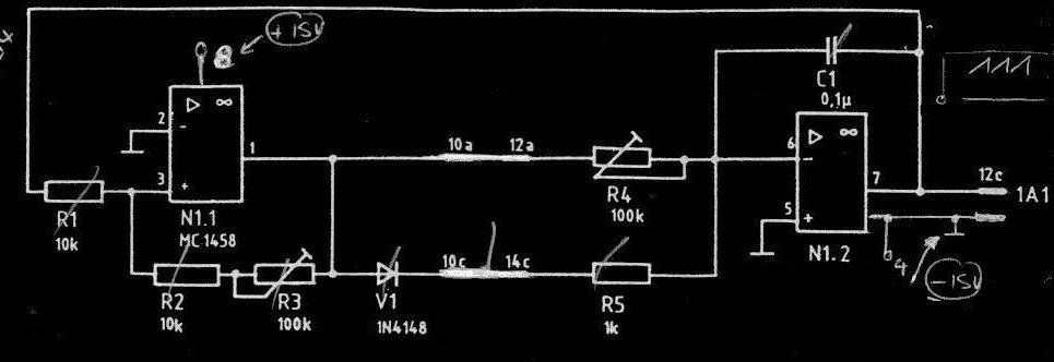

i make small circuit that and need to inecress the frequency its 3.05khz and i need 30khz any need in your mind
what are you using to generate the original signal
its MC1458 here is the circuit

Try changing C1 from 0.1uF to 0.01uF (or 10nF)
I dont know that cct and cant b arsed to figure it out. But since it is a clocking cct and clocking cct need timing caps and C1 looks like it is in a feedback kinda arranement then it MUST be the timing cap. By making its value 10x less the freq should go up by 10x.
