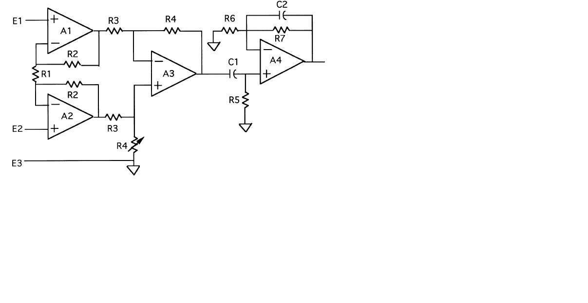

hello people...
i have attached a circuit that acts as an amplifier for biological signals... E1, E2 and E3 are the electrodes that will pick up the signals from the human body... these signals are amplified and filtered...
As u can see electrode E3 is the reference electrode or the ground electrode... i have a problem here.... the op-amps used must be provided with a +/-12V dc supply...
where must the ground of the power supply be connected to? i cannot connect it to the same ground as E3 (the reference electrode) as the user ight experience shock...
i need to isolate these two grounds, otherwise the circuit wont work... can u pls help me?

The user shouldn't experiance a shock because the op-amp inputs have a very high impedance and the current flowing would be far to low to shock.
You can build a +/-12V supply from a 9V transformer, a couple of diodes and a capacitor. Of course it won't be regulated but op-amps don't need a regulated supply.

thank u for the circuit....
i already have a dc power supply that gives me +/-12V dc... now that DC power supply box has a ground pin that we connected to the ground that i have shown in the diagram....
in that case i sensed a minor pain in the place where i connected these electrodes.... (luckily a minor... :).... later on i read about isolating these grounds.....
how can i achieve this?
Are you just measuring AC signals?
I'm surprised it shocked you. I suppose 24V on moist skin it liks a 9V battery on the tongue.
You could just add 100nF capacitors to two of the inputs.

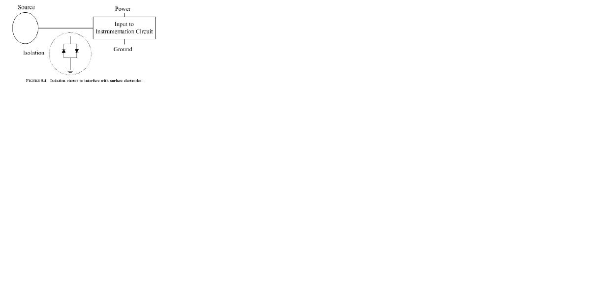

i came across this circuit which i have attached below....
the description goes like this...
Before hooking up electrodes to the user, build the precautionary safety circuit... the source refers to the user who is going to put o the electrodes...
will this serve my purpose?? i have also heard about opto-isolators....
