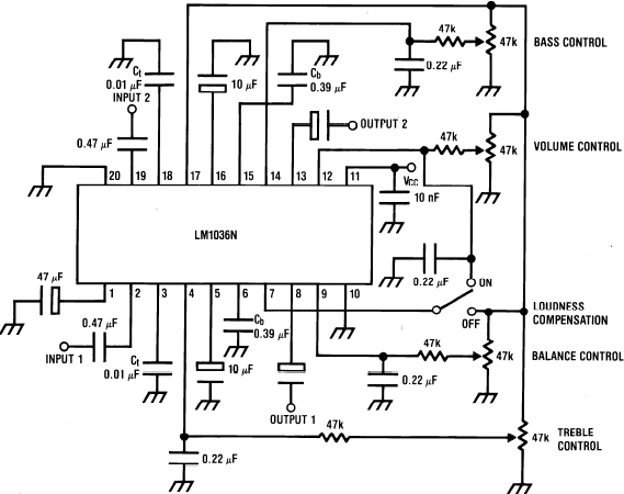

Have a project that is kinda frustrating since I know little about analog circuits.
Have a line level output coming from a dac (0-4V) but its a little odd b/c it seems to have a flat carrier signal of about 2.75V. And I would like to output a crossed over output at about the same 0-4V but with some basic EQ added. So 2 stereo pairs come in, 4 stereo pairs go out (Left-Hi, Left-Low, etc etc)
Its some stupid custom dj equipment that was made by god knows who and I have a friend that wants to get this hooked up to a car amp.
Now, the problem is for one I dont know what this carrier is and if its ok to feed it along to the amp or not.
If I can get that sorted out I would like to add a simple EQ to the output (bass, treble, volume control, fade, balance, etc etc), nothing real complicated.
But I'm not sure if there are ICs that handle this or its all going to be separate circuits for each function. I know there are some ICs to do this when its a digital format, but don't really know what to look for if the signal is already in analog.
Anyone have any ideas ?
The "flat carrier" might be some of the digital clock leaking out. It might destroy tweeters or even kill an amplifier.
You could use an LM1036 tone controls IC:

I'm pretty sure the 2.75V carrier is not a problem. Rather a design intent. The whole system came with an amp but its gone now. So I don't really know what was in it, but it was a modified car amp. I think it may have had a dsp or some sort of other unusual processor to find in an amp. But it was really low wattage anyway, so.... a new car amp would be a perfect replacment, but I have no idea why they would have wanted a carrier
I understand why a flat signal like that might be harmfull to a tweeter. I'm thinking maybe it might be removed prior to amping or for all I know a good amp might remove that already.
I think this was all designed so some sort of standard. But maybe just some made up goofiness. Either way, I'm pretty certain its supposed to be there.
Thanks audioguru, I like that chip. It has balance but it seems like its missing fade though (?). I guess if they only planned two speakers then they wouldn't need fade.
I have a left +/- and right +/- so I think I would need 2 of these chips. Then take those two outputs and use some sort of crossover circuit to cut them up so I have a front highs, front mids, rear mids, and maybe even a sub output. Should just be where and how many crossovers I have I would think.
I'll try searching for other audio control chips, maybe someone has an expensive all-in-one ?
I have never seen an audio processor IC that has crossover circuits and is analog. Car audio equipment all use DSP now.
I guess I could do this with 4 of these ICs (if I want the fading, I think I need to use 4), or DSP.

You only need one stereo tone controls circuit. Then the faders are just a stereo potentiometer that feeds the 4 crossover circuits.

The description is next to useless, but it sounds like it might just be sat on a DC level - no coupling capacitors, they may have been in the second half of the unit. Adding coupling capacitors may be all that's needed?.

You're confusing yourself again - it hasn't been 'added in', it's how amplifiers work - you have coupling capacitors to pass the AC and block the DC levels.
Usually, for seperate units, you would have a blocking capacitor on the output of the preamp, and another on the input of the power amp - however, only ONE is actually required (as long as they are only ever used with each other).
In your case it sounds like the blocking capacitor was in the following section, and not in the preamp.
There's no calculations really required, ANY capacitor will block the DC, it's just a question of a big enough one to pass the lowest frequencies you need. To calculate it you would need to know the input impedance of the following stage - but I suggest you stick a 10uF in there, with an electrolytic connect the +ve to the output of the preamp (where the 2.75V DC will polarise it), and the negative to the following stage - you may ned to add a resistor from -ve to 0V, if there isn't one in the following stage (not critical, 47K would be fine).

Cheap twisted pair is used for balanced telephone lines, not unbalanced audio that needs shielded audio cable to avoid interference pickup. The DC level on the signal could cause distortion, not noise, in an amplifier following it if there isn't a coupling capacitor to block the DC.
