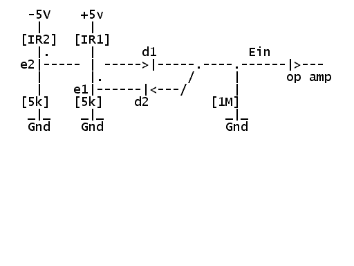

Q1 < how can i know the circuit are using a sensors? >
A1 the circuit schematic might help.
Q2< what kind of circuit using op-amp and has 2 sensor? >
A2 a single op amp could distinguish btwn 2 sensors.
( see < ATTACHMENT > )
The example circuit gives:
1. IR_1]Lit ; IR_2]Dark then Ein > +1.0
2. IR_1]Dark ; IR_2]Lit Ein < -1.0
3. IR_1]Dark ; IR2]Dark Ein =0
4. matched components, IR_1, IR_2 receive equal light
IR_1]Lit ; IR_2]Lit Ein =0
hawk2eye
Why use text to make a simple schematic? It looks like Chinese writing.
I draw straight lines and copy and paste things into Microsoft Paint to make clear schematics.

i don't understand it......,
sensors
Is the ATTACHMENT drawing too hard to understand ?
OR should I explain in more detail ?
hawk2eye
Yes.
It is not a real schematic, it is just a bunch of text punctuation marks that don't mean anything.

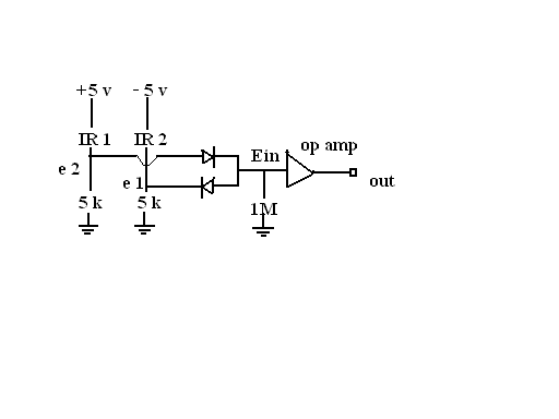

new schematic ( drawn using MS Paint...thank you < audioguru > )
disregard old schematic !
The new schematic example circuit gives:
when infra red sensor is lit, IR_x]Lit <10k
when infra red sensor is dark, IR_y]Dark >200k
case1 IR_1]Lit ; IR_2]Dark Ein > +1.0
case2 IR_1]Dark ; IR_2]Lit Ein < -1.0
case3 IR_1]Dark ; IR2]Dark Ein =0
case4 matched components, IR_1, IR_2 receive equal light IR_1]Lit = IR_2]Lit Ein =0
hawk2eye

I don't know why diodes are used when an opamp has two very sensistive inputs that can be used instead like a comparator.
Perhapps you should read more about opamps.
