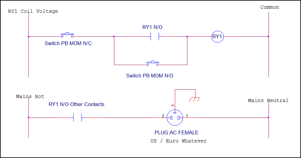

Sure if you have a N/O and N/C push button switch and a 24 volt source for the relay coils. Just a matter of making a relay latching circuit. I can give you a basic drawing if you would like. You will need a power supply for the 24 volt relay coils and at least a DPDT relay in the lot.

It would look like the attached. Since the OP is UK I would assume 220 VAC mains. Sorry about the PB switches both looking N/O as I didn't have a good looking N/C switch. :(
The attached assumes that RY1 has multiple contacts.
Ron

What I would need though is an off switch built in too, as I will be using the circuit to both turn on and off the sander. I reckon a N/C switch in the relays coil line would do the trick nicely though and I have some!
I may have caused some confusion about the original thread name as I didn't know the correct terminology for the setup. Some of my other workshop machines, table saw and router table have this setup and they just have a green on button and a red stop one, but as I said earlier it also serves to make sure the machine does not start when plugged in UNTIL the start button is pressed.

hi Al,
From what you describe, you need a mains powered relay that applies power to the tool via its contacts.
The Power On switch energises the mains relay and a contact on the relay applies latching power to the coil.
The OFF switch breaks the relays self latching contact path.
If you need a sketch, let me know.
