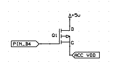

I included a quick diagram but I'm thinking its layed out of N-Channel all of a sudden. I've got 4 other project I'm working on and I know I've got to be making mistakes somwhere :)
I need to check and see if this is correct or not, also I need to figure out how I should bias this.... Or if I even need to ?

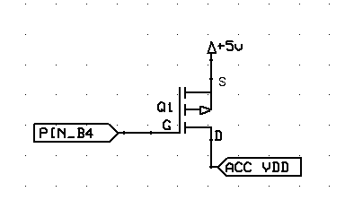

Close, but no cigar. See below. No biasing needed, if your logic input swings from zero to +5V.
And it does have to be P-channel.

Edit: I'm dumb just noiticed I used G instead of S.... sorry, hit the wrong key apparently.
Ok, I'll make the change.

I think you know this, but be aware that the PMOS is ON with the gate at zero volts (GND), and OFF with the gate at the same voltage as the source (+5V). As I pointed out above, be sure you use one that has Rds(on) specified at -4.5V or less (actually, I guess -2.7V is MORE than -4.5V, but I think you know what I mean).
