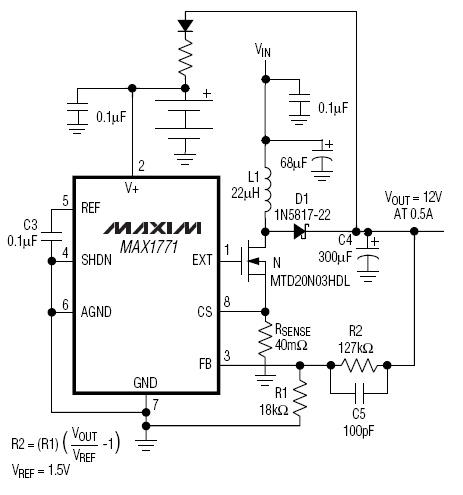

I have a fuel cell that produces between .4 and .9 VDC, with current increasing as voltage decreases, max current of 2 A. This .4 volt, 2 ampere condition is the most powerful. I would like to use the fuel cell to drive a motor, let's say 6 V. Is there any way to step .4 V to around 6 V? Is there some way I could turn the steady signal into a wave, without using semiconductors (so that I can avoid the .6 V voltage drop) so that I can step up the voltage with a transformer? Thank you!

You could build a DC-DC Step Up or Boost converter. THe LM3488 looks like a nice one for a good price. A DC-DC converter switches current through an inductor to generate an output voltage. Thay can be up to ~90% efficient and because they use a feedback loop to keep the output voltage steady you dont have to worry about the .7V drop you are talking about.

The start-up voltage is usually higher than the minimum operating voltage. For the LTC3400, the worst case startup voltage is 1V (0.85V typ), and the worst case operating voltage is 0.65V (0.5V typ) @ 25C.
The LTC3423 will work off input voltages as low as 0.5V, but needs a separate supply of at least 2.7V to operate its internal circuitry.

You could power it from a rechargeable battery that is trickle charged by the output of your converter. Or, if you could start it on battery power then automatically switch over to powering it from the output with a diode OR as soon as the output comes up.

Here's my idea anyway.
Use a rechargable NiMH battery to power the IC, this will be charged when the power is turned on. The IC uses so little power that a pair of 2Ah cells should last years. If you want to save even more power then you can pull the shutdown pin high to turn the supply off but it probably itsn't worth it unless it won't be used for a year or two.
This is just a quick modification I've made to a circuit on the datasheet, you'll need to reclaculated the resistor values to give the voltage you desire..
