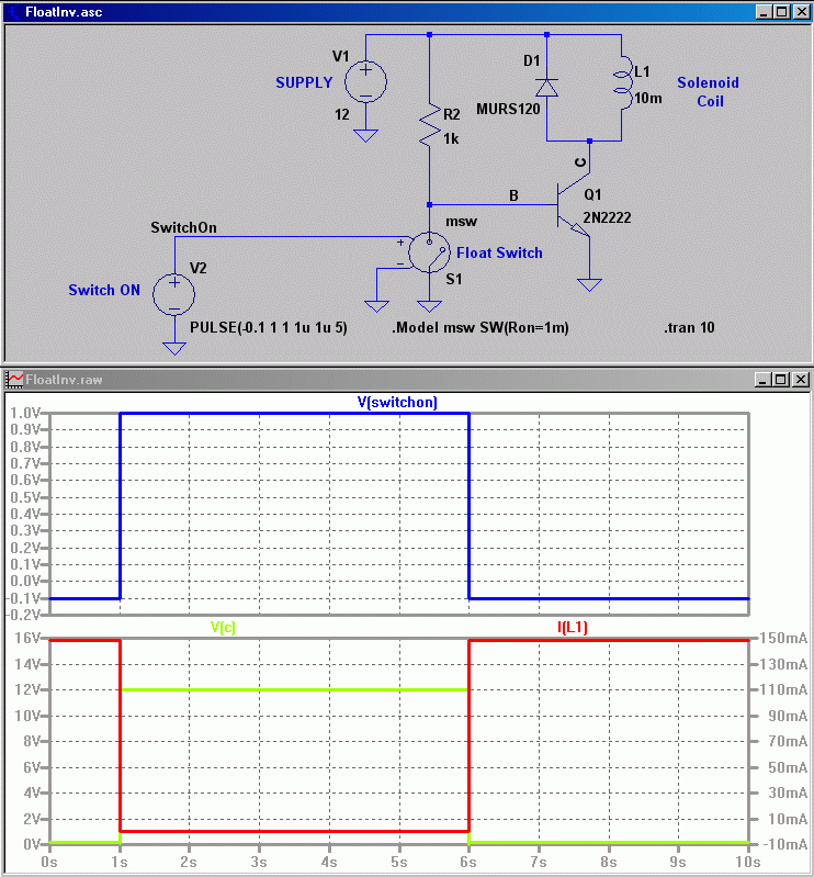

Basically, I want to turn on an "always off" 24V water solenoid valve. I have a float that has an integrated circuit that puts out an infinite resistance when the float rises to the top. So, what I would like is a circuit that puts out 24V when the float gets to the top (reaching infinite resistance).

The float is circular and fits around a hollow shaft that has a mini circuit board. The mini circuit board acts like an all or nothing switch, giving no impeadance until it reaches the top then it reads infinite.

Ok, I disassembled the float mechanism. I uses a reed switch that the float opens with a magnet when it passes over.
My problem still exists, I need to turn on a solenoid when the power is interupted. Any ideas?
Use a small relay controlled by the float switch. Use the Normally Closed relay contact to control the solenoid.
A transistor is cheaper than a relay. See below. If you care about static power consumption, use a FET and a 1meg or 10meg resistor.
