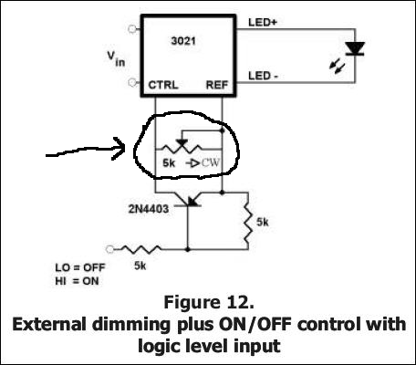

The attached schematic shows a "buck puck' LED driver with control and reference pins. Essentially changing the resistance value change the % of the available 700mA current applied to the attached LED's(Luxeon III's in my case).
Instead of manually changing the brightness I want a chip to do the work.
For Example: Beginning at 40% initially and each step (aprox 1 min.) increasing 5% until 100% is reaches. Once 100% is reached it should stay at 100%.
Any suggestions on what type of chip I would need to accomplish this?
My friend has a "MicroChip" Programmer board so it would be good to use something I can program.
Essentially I want the LED's to begin at 40% brightness and work their way up to 100% within about
15 minutes.

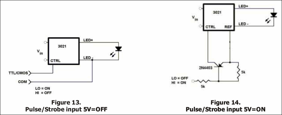

External Pulse/Strobe Control
Figures 13 and 14 show two methods for low speed pulsing or high speed flashing operation. In Figure 13, a TTL/CMOS logic signal is applied to the control(Ctrl) input of the 3021. The output current will be zero when the control signal is high. Note that the input needs to source a minimum of 4.75VDC into a 1Kohm input impedance. Also, as is also the case with a dc control signal, the logic input ground to be common to the LED-output terminal.
Figure 14 shows an inverted input configuration using a 2N4403 or other PNP switching transistor. In this case, a logic high will cause the output to be "on". In either configuration, the rise and fall times of the output will be 25micro sec or less. A pulse frequency up to 10kHz may be used.
audioguru said:
10kHz is fine. You can't see it blink when the frequency is higher than about 50Hz unless it is moving or you are moving your head.
Then, assuming 10KHz is 100%, It would be possible to get the desired effect from a freq range of 40KHz - 100KHz. Yes?

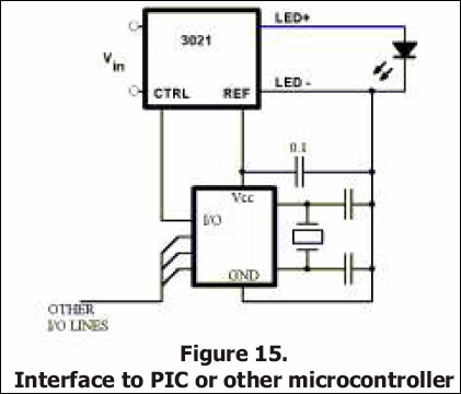

Ok, we may be getting closer. That period and those duty cycles will be relatively easy to do even on a small 8 pin PIC microcontroller.

If you setup a basic interrupt to count seconds and minutes, then your 90% through the battle.

The above program will provide an interrupt driven timer. Very useful tool for countless applications, for your use, perhaps the "main program" could consist of;
