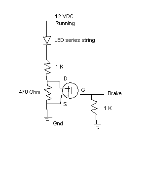

I am working on an LED-luxeon replacement taillight and turn signals for my motorcycle. I will be using a current/(maybe voltage too if i can figure it out) regulator to control the brightness of the led. To keep things simple i am just going to use the running circuit to power the LED array, and the brake circuit will just be connected to the relay and will switch between resistors for the regulator, which will adjust the output. i dont want to go with a relay b/c of the slower switch speed, and the EMI when discharging. Effacy is the most important part of this circut. I used to be ok with circuits when i was younger, but its been like 10 yrs since i've messed with them and alot has changed, and i've forgotten alot. are there any good mid level "circuit for dummies" type books that explain all the new things out there? just to give u an idea, it was about 1995-1997 when i dabbled in electronics last
To be as simple as possible, you could skip the relay all together and just bypass a resistor with a FET. What you could do is workout what resistors you need for the 2 brightness levels. Then subtract the value of the lower ( brakes on ) resistor form the running resistor to get the value you need to bypass with the FET. For arbitrary numbers, say the running level needs 1.5K and the brake level needs 470 Ohms, the math gives 2 resistor, about 1K and 470 Ohms, using standard values. This means you would put the 2 resistors in series, giving you the running level, for dim. Then you would connect a FET, say a IRF44N across the 470 Ohm. Please refer to the worlds crappiest schematic drawn below. I have added a 1K from the gate of the FET to ground to help keep noise from turning it on.

that would work perfect, thanks.....i really need to get up to date on all this stuff.... even moreso considering i am looking at going to school for electrical engineering.....humm....looks like barns and noble's road trip tonight after work.
