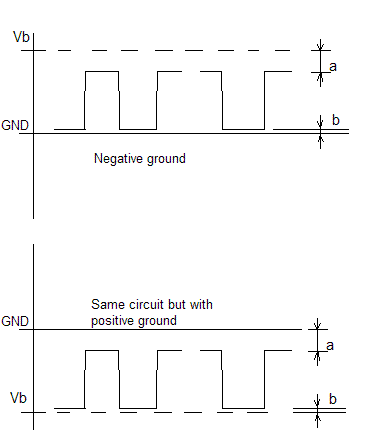

you got it, the level will not really be rail to rail (I guess you had 5VDC source in mind) because there is some drop on output transistors.
see following example and note that a and b are not necessarily symetrical:

Thanks alot guys for the pictures and help
