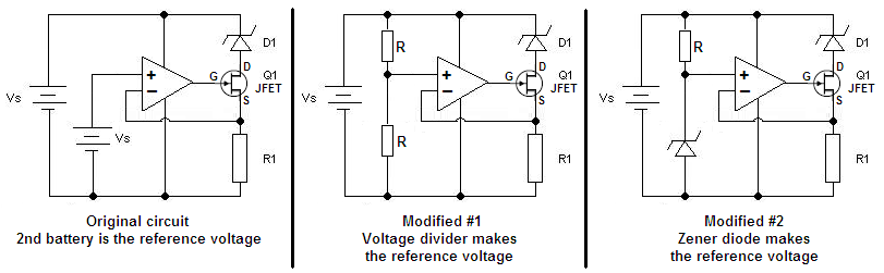

The dc-dc converters are to power an op amp with +ve and -Ve suppply. The op amp is part of a constant current circuit. (ive posted this circuit on here years ago and i still use it today when i require a constant current source), however i made a cock up in the ordering and now i am trying to find an easy (cheap) solution.
I thought i might be able to get away with a postive and gnd connection but it appears the circuit does not perfrom as a constant current source with only a positive supply. I think its perhaps because the mosfet requires a negative supply to completly turn off the fet. Thats my analysis anyway. The circuit works fine when suppled with a +/- supply.

below is the link to the circuit. Audio Guru and Nigel may remember this circuit when i initially discovered it back in 2005.
https://www.electro-tech-online.com/attachments/voltage_comparator_366-png.6472/
That circuit only shows one power supply, and generally only needs one. If you can't get the FET to turn off, you may need to select a different op amp, one whose output can go to (or at least nearer) the negative rail.
Why don't you show us how you are really using it. I doubt you are actually using a battery or power supply for the reference. And are you actually using this circuit to bias a zener?
EDIT:
A thousand pardons, Andy. I looked at your schematic again and noticed you are using a JFET. A MOSFET would allow you to use a single supply even if the reference voltage is near zero.
Nigel / Audio i would greatly appreciate some advice here. Thanks
It looks like the opamp and FET are making a constant current for the zener diode. If the zener diode has a fairly low voltage, the output voltage of the opamp can go low enough and the FET doesn't need a high gate voltage then two similar circuits should work with a single supply like these:
Andy, I just noticed that you are using a JFET. Is there any reason you can't use a MOSFET? It might solve your problem, since the gate-to-source voltage will be positive, instead of negative as it is on a JFET.

Are the DC-DC converters the isolated type...negative input has no ohmic connection to the negative output? If so just use two of the cheap converters. One with its negative to common and the other with its positive to common. If not...or if I missed this earlier...just ignore this. :rolleyes:
Ken
I agree with Ken, he just beat me to it!
