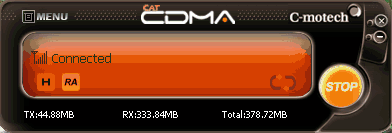

Hi Ron,
I'll check the AVG setup and see what will change. I've now activated the windows xp firewall, but I'm not sure if it provides enough internet security.
The modem I'm using is a wireless modem (CDMA - C-motech), connected to a 14 element long yagi antenna and to the USB-port.
I do neither use a wired nor a wireless router. The network should route the modem to my stepdaughter's PC which it does if the AVG firewall is disabled.
Here is an image what the user's panel looks like.
Regards
Hans
