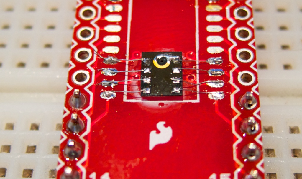

Never underestimate the ingenuity of hobbyists. I know a quite a few hobbyists that use surface mount devices all the time, and not just the young ones with good eyesight and nimble fingers. Lot's of old guys too. I've used a few of them myself. I can't say that I like using them; they're a pain, but often there's no other choice. Like any new technique you make a terrible mess the first few times you attempt it, but then you get better and better. And yes, you'll have to buy or make some new equipment.
the smallest I have been able to use in a 10-PIN DFN 2 mm x 2 mm x 0.85 mm etching that board with toner tranfer was just the fun part, soldering it was even more fun...:banghead:, Now I learned to check the size on a print out first.
Packages like SOIC, SOT, and even TSOP can be hand-soldered fairly easy.
But the leadless packages (and there is a whole alphabet soup of those) are essentially of limits to hobbyists.
If one requires to use one of them, better find a breakout board from Sparkfun, Adafruit or even (gulp!) Ebay.

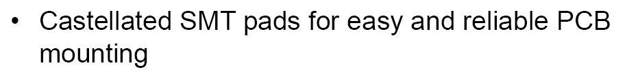

For the RN42 Bluetooth module, not precisely an SMD IC,
the datasheet mentions:
which are located 1,2 mm apart.

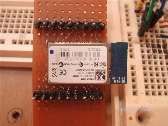

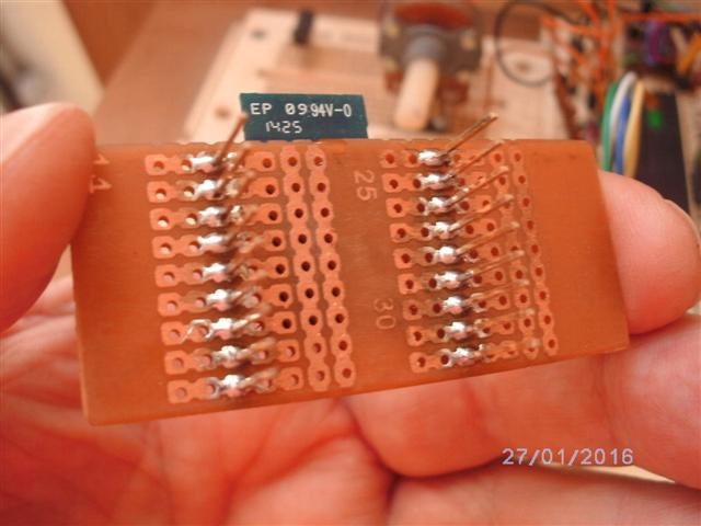

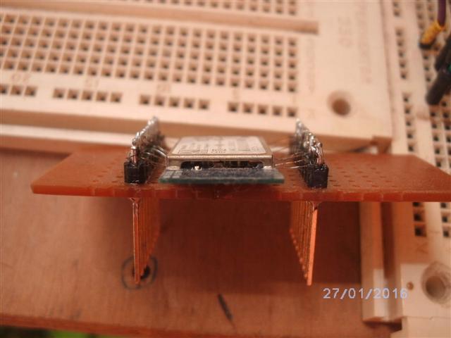

I know a guy, who soldered one, in a somewhat unusual way to have it ready during a long weekend so he could start testing his code to command it with a micro in less than 48 hours.
He is 69yo, suffers of trembling hands most of the time when soldering and has very tired eyesight.
At 19 USD apiece, damaging one was not the nicest option.
But, in spite of all against, I succeeded.
