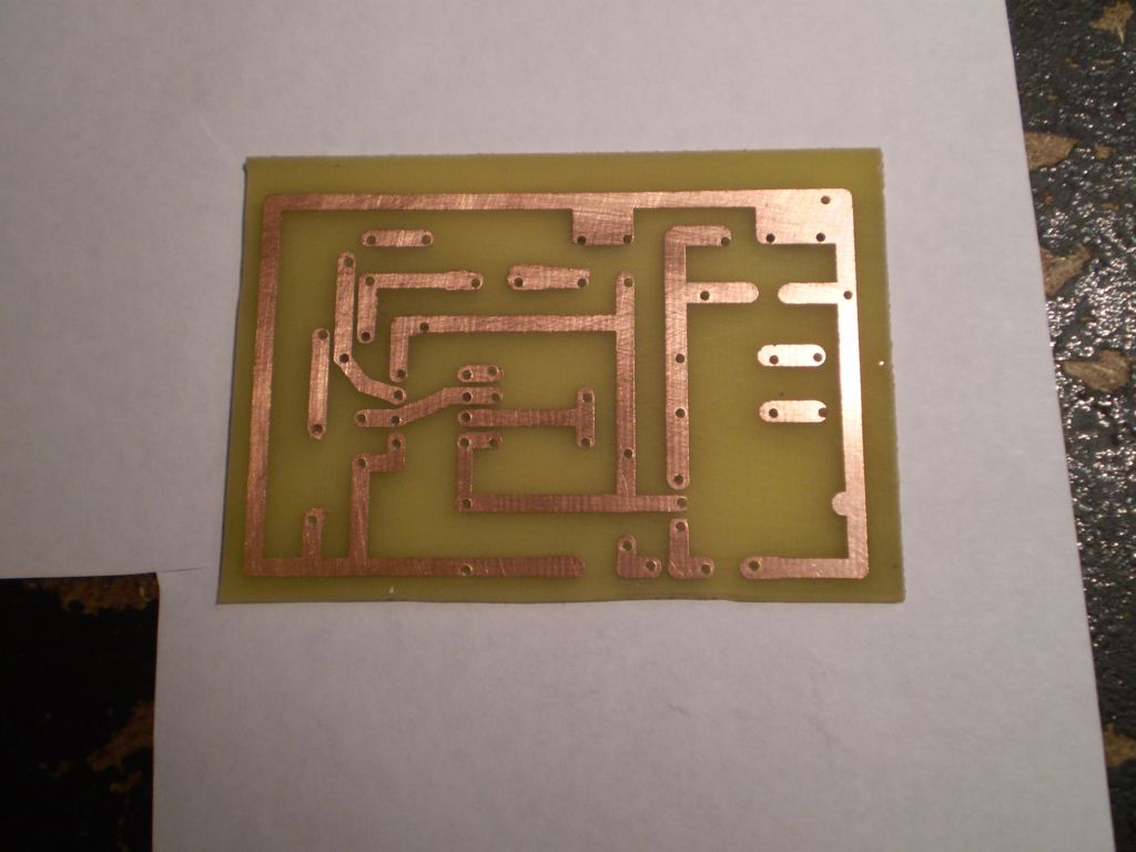

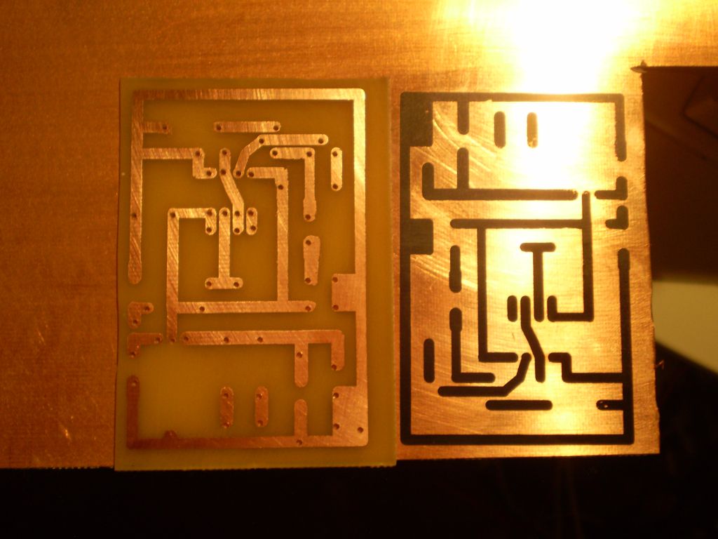

I just picked up a Samsung ML-1865W for $49 on sale about a month ago and it works great for making boards.
jer :)
