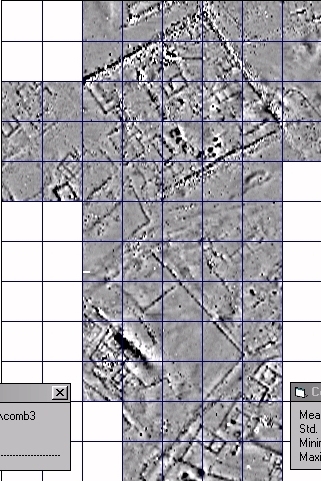

As far as finding where cars and tractors have been, I was measuring the magnetic fields in the earth. The flux lines twist around the car and trucks. When the tractor was removed the flux lines distorted for months. Look up “Magnetometer” “T-Coil Magnetometer” “Fluxgate magnetometer” “3 axis Fluxgate magnetometer”. I have video of people using ‘differential magnetometers’ to find twist in the earths flux. It is very revealing.
Below is a map of 2000 year old building remains in a field. He walked across the field every two feed and recorded the flux lines. It does not mater that the field was plowed hundreds of times. I know people that can find the same walls by walking with a piece of metal in their hands.
Last time the phone men came to repair the buried line, one man had a wire tracer machine and the other had a copper wire in each hand. They both said they could not get the other method to work.
