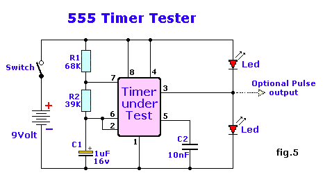

LED's work better. They are lights, but they only light when connected a certain way. If you want the brightness of a lightbulb, then you want a high current. Don't go too high or the LED will malfunction. To find the optimal brightness, connect a 1K resistor the LED, and the battery in series (in a loop). If it doesn't work, reverse the battery connections.
Now adjust the 1K resistor. The lower the resistor, the brighter the LED.
Test it...
This circuit will blow the LEDs.
I suggest you insert a 1k resistor in series with each LED to limit the current.

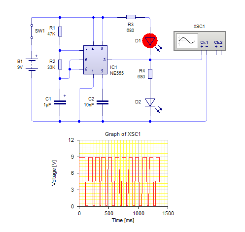

jasona@wbeer said:
ok got it to light up but the led dose not flash
Try with bigger resistors. Chances are, you can't see the LED flash because it's going too fast. Go with resistors in the 10k-100k range. And don't forget to put a current limiting resistor to protect your LED like Len suggested.
