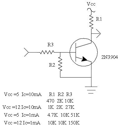

Here is a schematic of one using a 2N3904 transistor. If the input isn't floating then you do not need to use R2. I did not know what voltage you are using so I calculated values for Vcc of 5V and 12V. When the input is high the output is low, when the input is low the output is high.

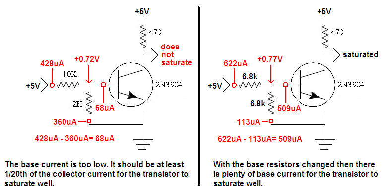

I think the base current is too low for the transistor to saturate well.
When it has a 10mA load then its max saturation voltage is 0.2V when its base current is a whopping 1mA. Compromise with a base current of about 0.5mA. Your base current is only 68uA because you are throwing away too much current to ground.
