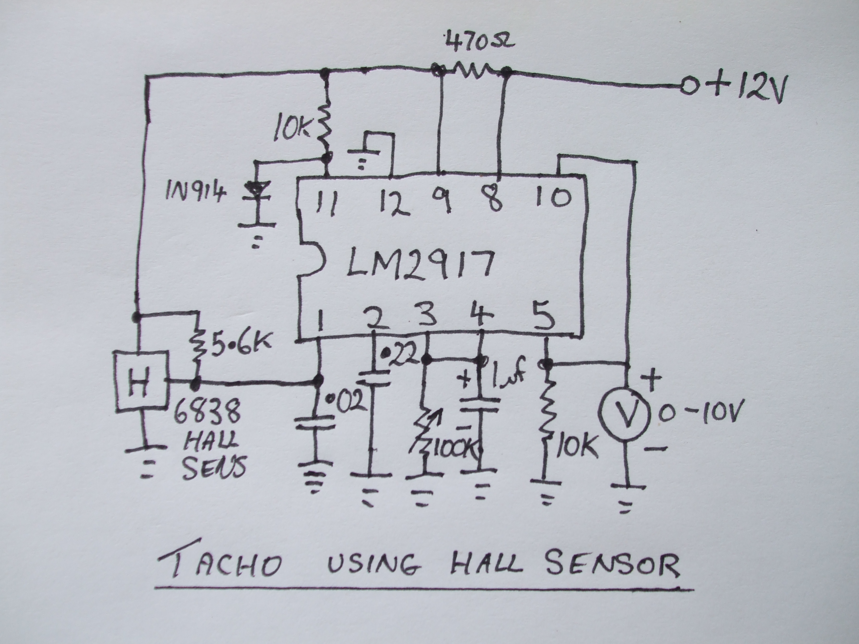

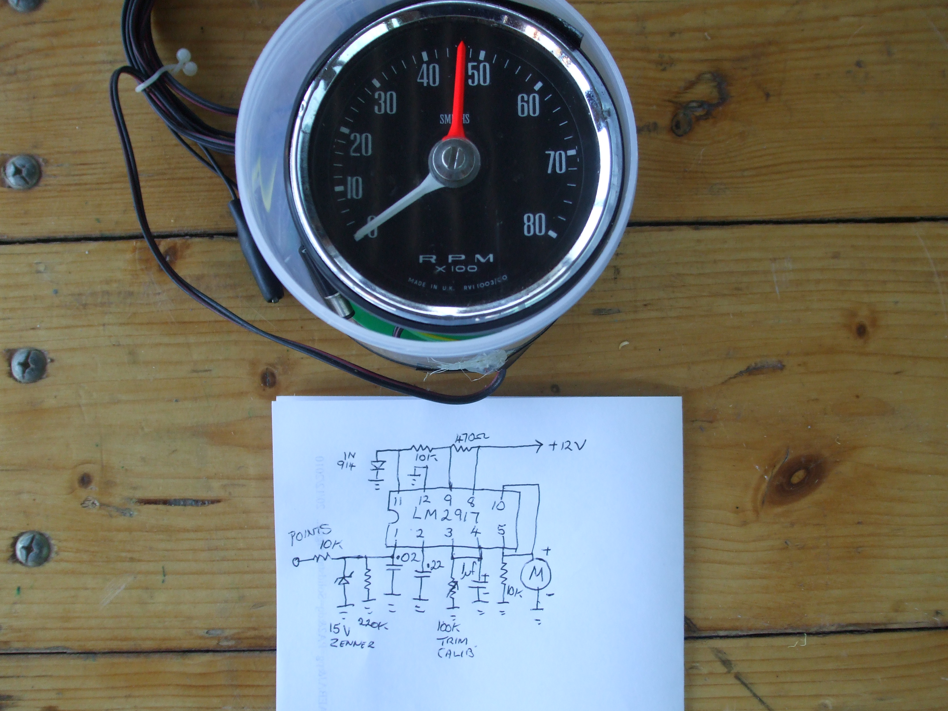

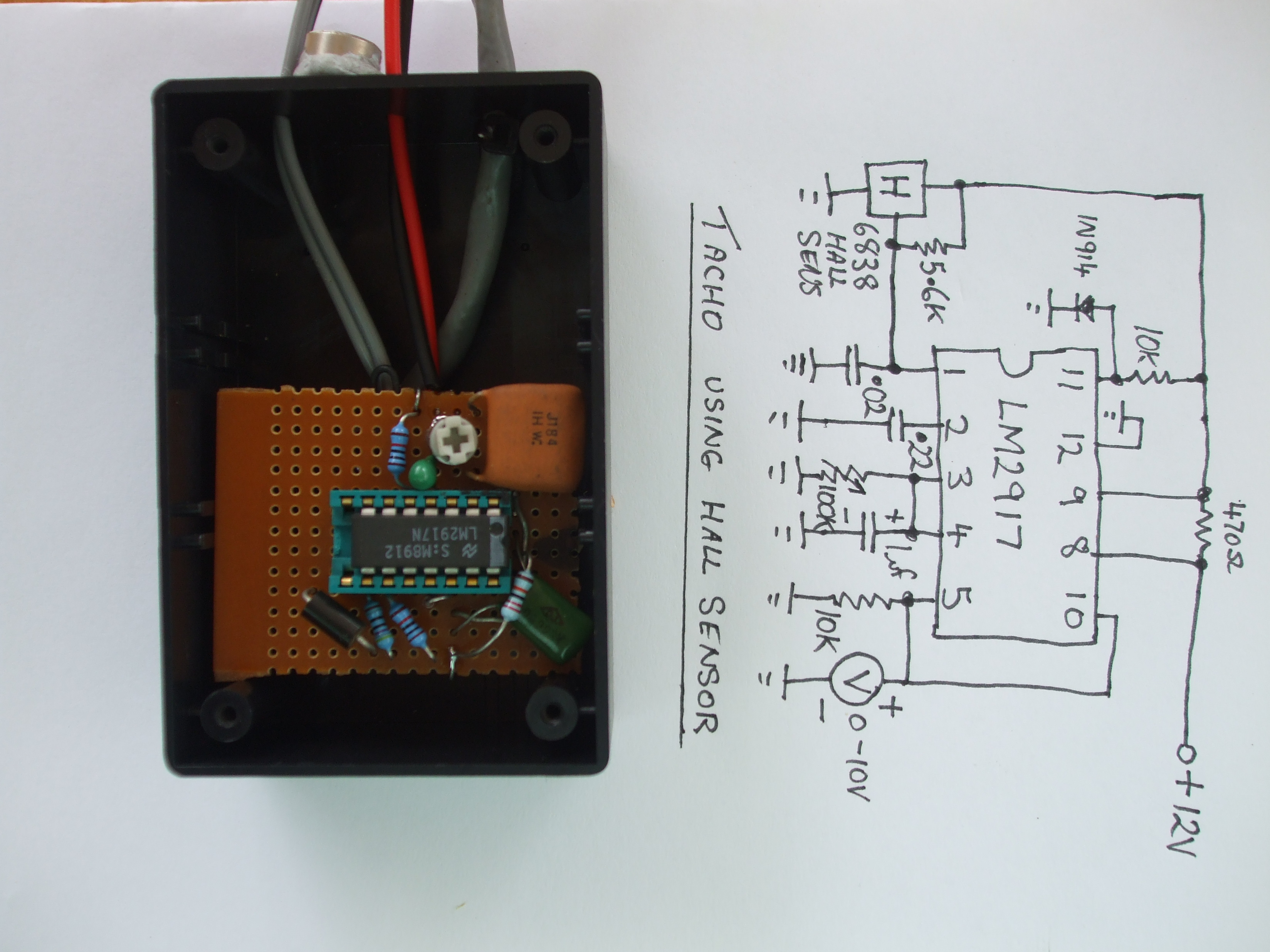

2 circuits ive used for single cylinder engines, one using a hall device salvaged from an old VCR reel sensor . The other using points, or can be used by wraping about 8 turns of wire around the spark plug lead as a pickup point. Daryl

ok MR RB could you please explain how that would be done i posses no electonics knowledge and i have seen shematics for that but i dont understand them if i can find the one i have seen and post it can you or someone please explain it to me (in stupid people terms) it would be alot of help cause one of these race kart tack goes for any where between$200-400 maybe even a little more so i was tryin to go a cheaper way and this seemed like this was it only i seem to have got in over my head thanks
How about this or something similar?
No electronics skills required.
Here's a redrawn version of your "tacho" drawing. Not that yours was bad, mind you. But notice the file size difference (~9K vs. ~1,800K):

To explain further, if you decide to use this little circuit, it can be very easily made from parts that are very available, maybe even locally. It can be built on a little piece of perfboard (insulated phenolic board with lots of holes drilled in it), or some other method; no need for a printed circuit board or anything. Probably the hardest parts will be calibrating it; the adjustable resistor needs to be set, and the meter scale needs to be redrawn if you want it to read directly in RPM (or you can just leave it and put a conversion table next to it, like "5 volts = 1000 RPM" or whatever). Requires a little soldering skill, but that's about it.

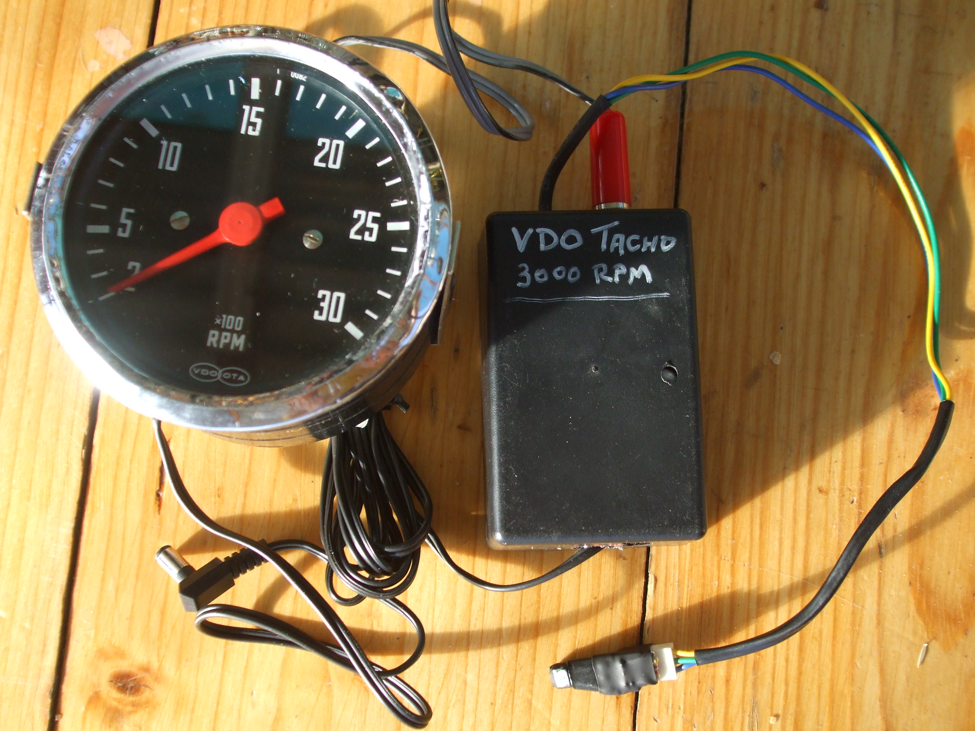

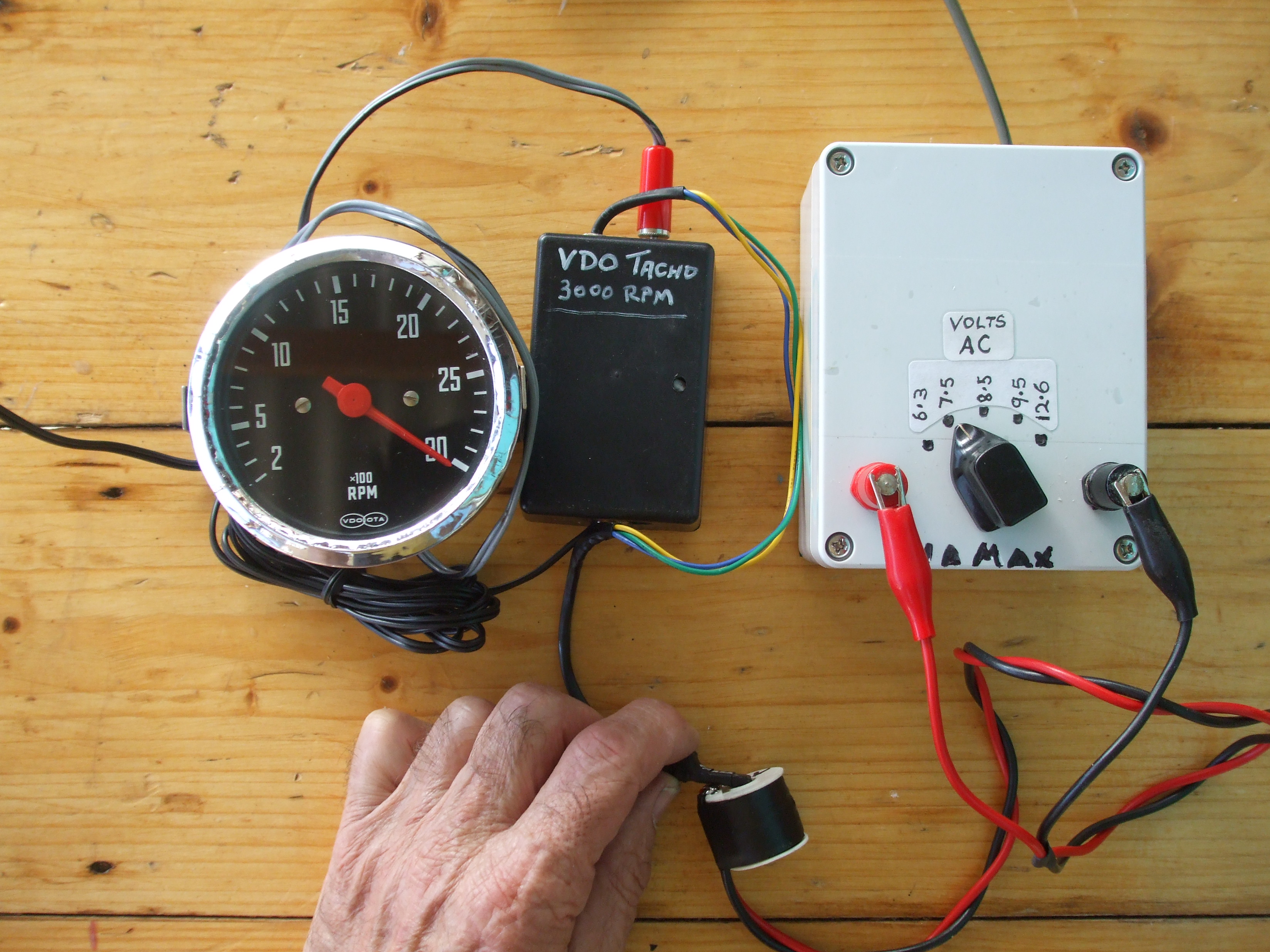

To calibrate if your using a Hall device I used a small coil to triger the Hall. 50HZ gives 3000RPM. 60HZ gives 3600RPM. also pic of the completed circuit. You will notice Ive used recycled Tachos, prefer these to digital as they are quicker to respond to RPM changes.
