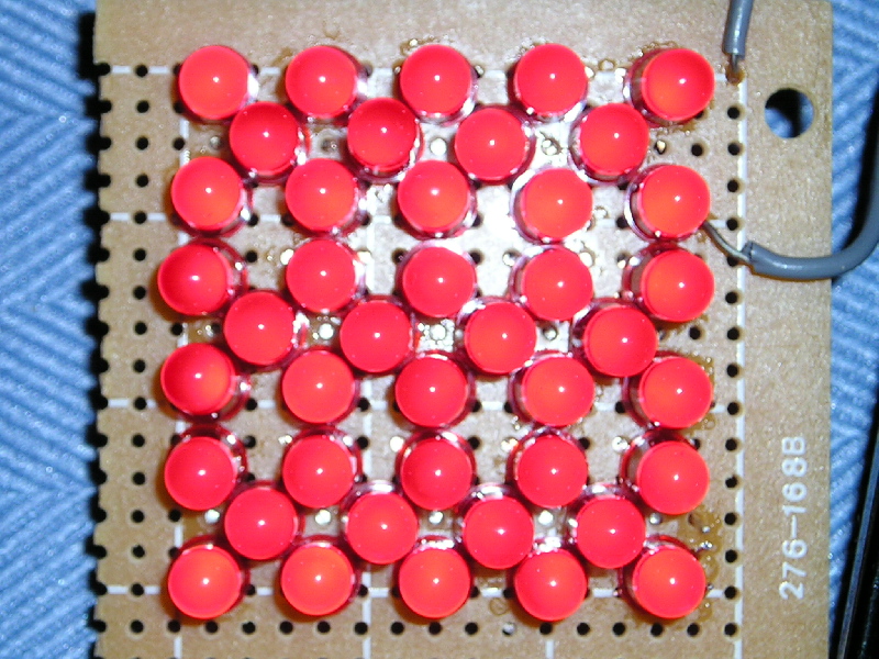

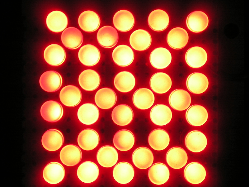

I was just playing around and built a LED array on a rat shack PCB.
The array can handle 800mA but it get somewhat warm, not hot.
I and using a 100ohm 3 watt resistors to limit the current at 12 volts.
These LED are 5 volt with 40mA nominal current, to work this array I series'ed 2 LEDs, then terminated one off the the positive to the middle of the series. It works and yield 1.6 volt drop and the current nominal is a little more usefull. At low power these leds show the tolerance in brightness. If the 2 series LEDS are close the voltage divide is almost equal so this current drove the middle LEDS. The only reason I put these middle LEDs in was to cover the gaps up more.
14 banks of 3 running from bus lines, total 42 and can add more.
Without resistors, this array can handle 2 amps at 6 volts before avalanching or 47.6mA each. The limiting resistor can reflect higher current than what I used, if you what it a little brighter select like a 80 ohm. I set these up to switch between one 100ohm then switch to parallel 50 ohm, low then high beam:)
Oh and I used no clean solder.
