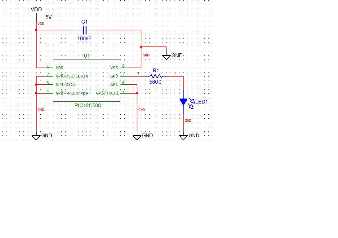

I'm trying to simulate a led circuit using a PIC12C508 (random choice).

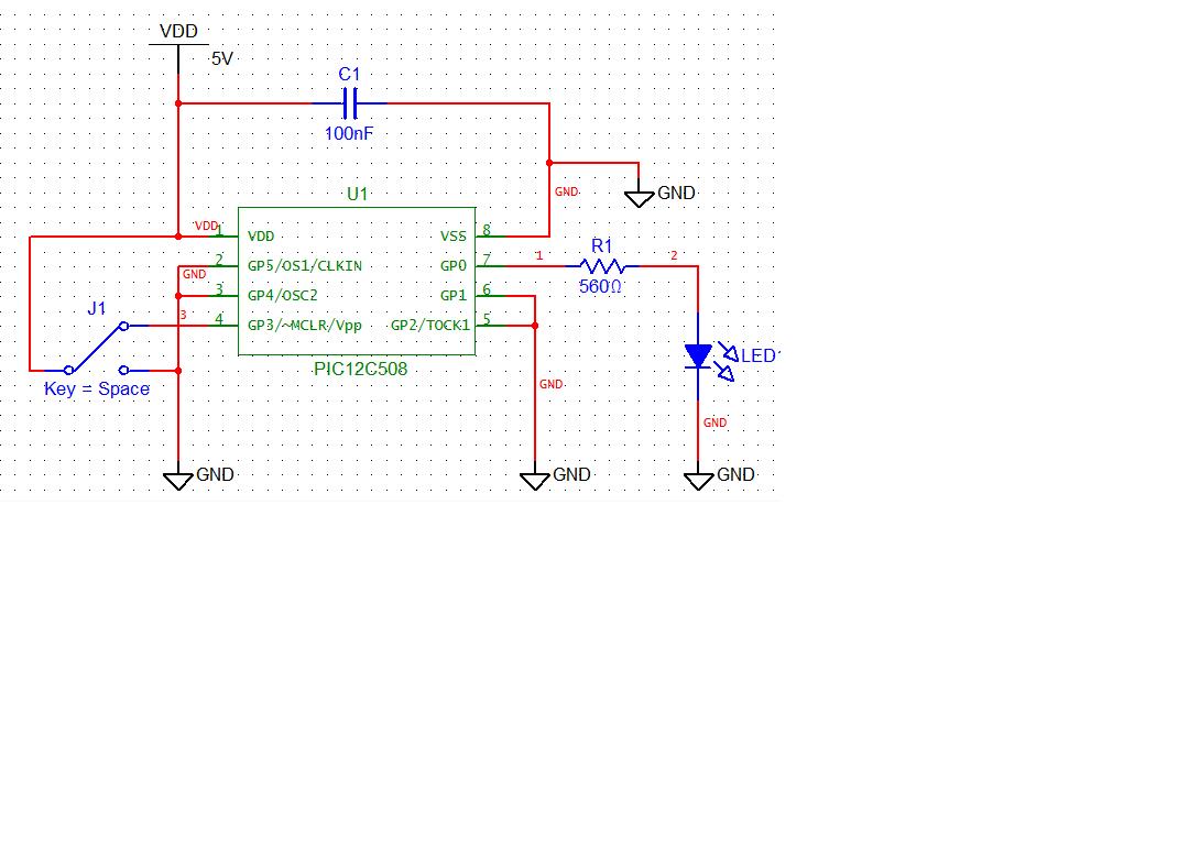

Here's a picture of what I have but how do I set the output to high without a program for the microcontroller in Multisim. I get close to 1V from GP0 but need at least 2.4V. I've thought of adding a spdt from source to GP3 and ground but that doesn't work. Just wondering how to control the microcontroller in Multisim 8.
By the way, should I look at getting Multisim version 10 for MCU function?
I'm very new to the practical part of electronics and have ordered both of David Cooks books so understand if I'm very lost.

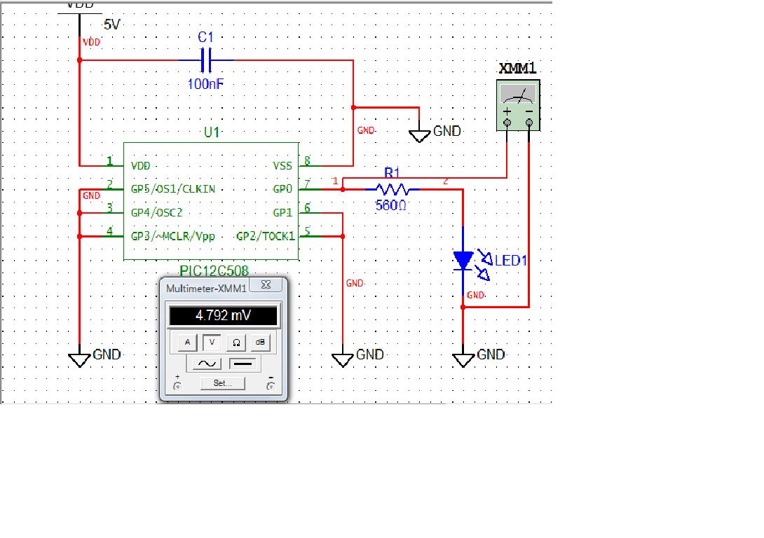

3 things to check:
#1. How much current can your supply output?
#2. What is the current limit on the output of GP0 ?
#3. Measure the voltage in 3 places:
1. Between Vdd and GND
2. Between GP0 and GND
3. Between the LED and GND
That will tell you alot about what is going on in the circuit.
I've checked in those spots but find I'm getting very little current at GP0. This is why I thought I have it wired wrong, am missing a control switch or am not using Multisim properly.

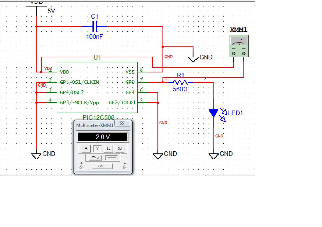

Here's a few volt measurements, one across PIC and the other across resistor and LED. I believe they should be the same but they are not. I also changed the resistor to 510 ohms...I was too high on the first circuit to trigger the LED.
Why all the pins grounded That's not good You have the chip in reset by holding mclr
to ground. The chips not running
They're not suppose to be? I saw it somewhere and thought it was norm....I'm new here. :D
be80be...thanks for the reason why mclr shouldn't be grounded...explainations are great....but I'm still lost as to why my voltage and therefore amps drop after microcontroller.

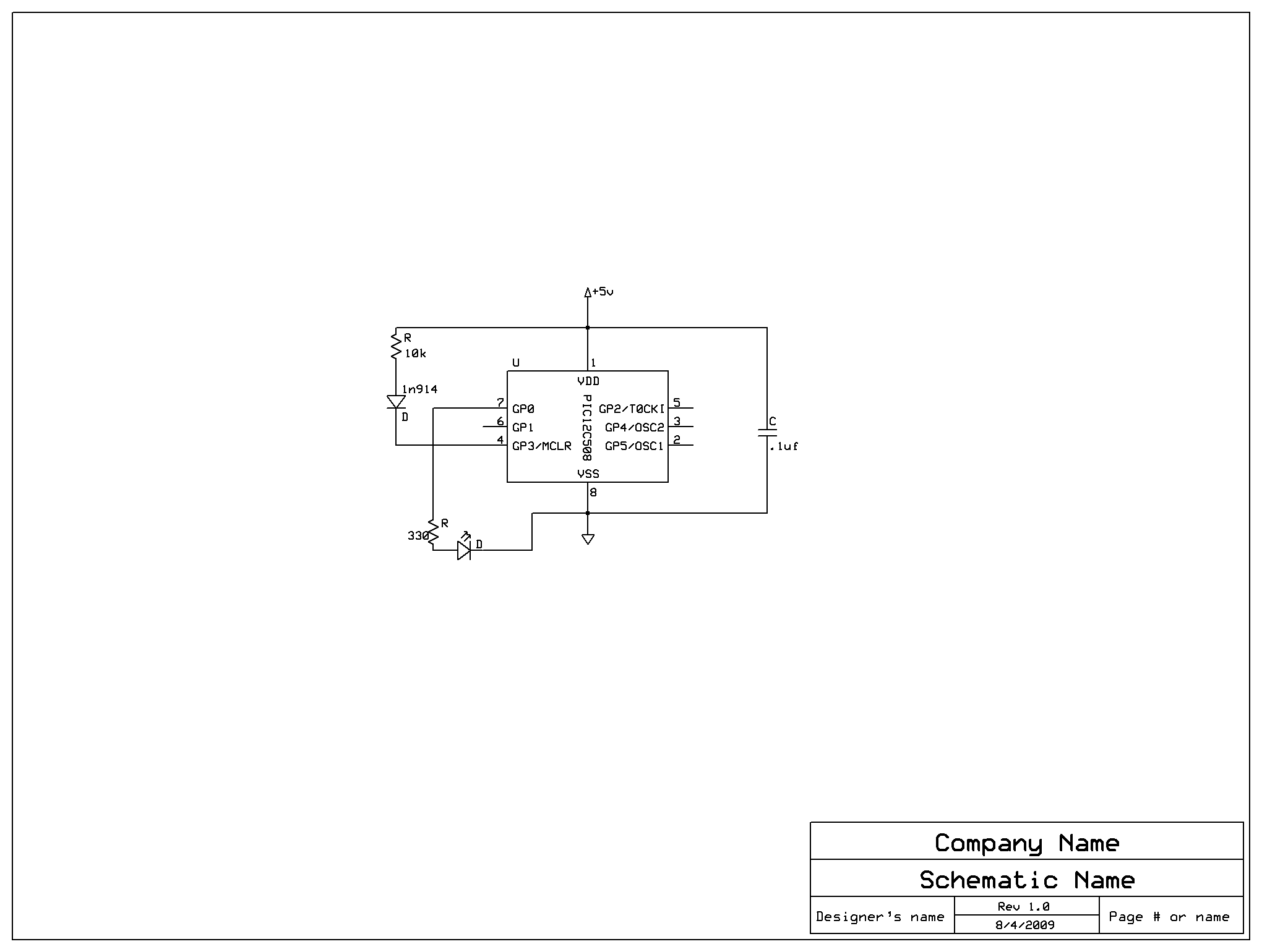

Well it like this I bet your grounding your chip in your code but you didn't post that I would hook it up like this
I haven't made a program code, just trying to simulate microcontrollers in Multisim. I'm wondering if I need to make a program for the microcontroller and run it in Multisim....is that how one controls the simulated microcontroller?
I understand that Multisim version 10 has a MCU function that allows one to run their code in a circuit inside Multisim.
How it going to do any thing you program it and run it. The program what makes the pins
input output high or low Like this It was for a 12f508 but it will work on your chip

Are you saying I can input a program like this into Multisim?
Or are you referring to real world simulation here....cause I'd like to simulate microcontrollers in Multisim first.
It ill be something like that. It has to be code that will run on the chip and the sim I have used use assemble like that.
