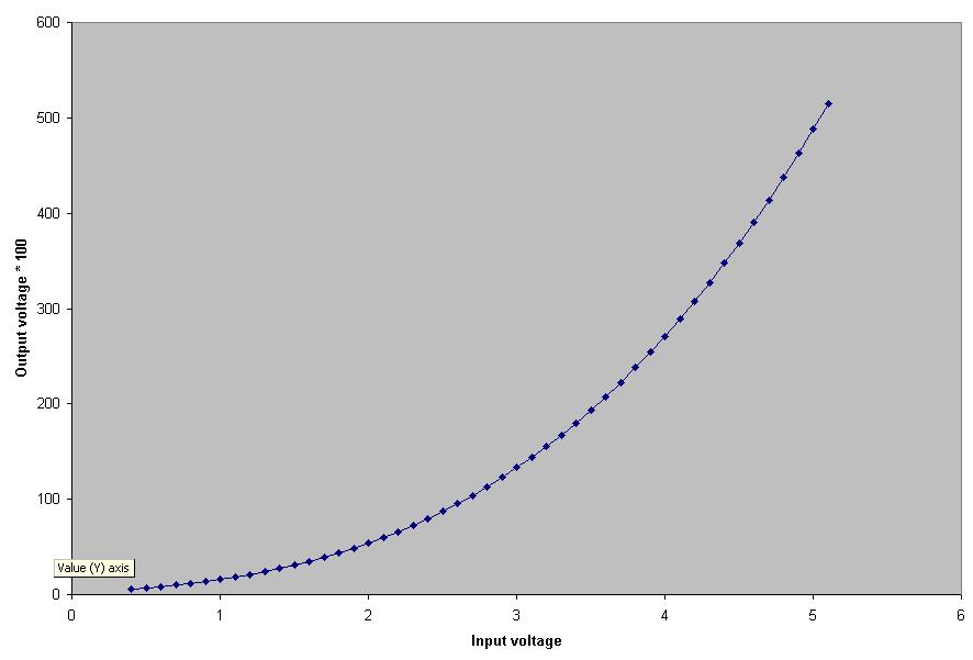

I'm new to electronics but have a basic understanding of how it all works. I want to convert a 5V dc signal into a different 5V dc signal. I have an input to output graph which i wish to impliment on the signal. What is the best way to do this? adc then maybe an eprom?? then a dac? Please could someone tell me exactly how this can be done.

I'm trying to modify a sensor output from a mass air flow meter on an engine, which has a range of 0-5V D.C.
I wish to modify it in a non linear way so i can't use a potential divider. Unfortunatly i don't have a copy of the graph on this pc but i've drawwn a rougth idea if what is needed on the attached file.

Hi Marcus,
I've heard of using an eeprom in just the way you talked about. The concept you are talking about is called a Look Up Table. While the EEprom will work dealing with the logic to implement the correct timing might be more trouble than it's worth. A microcontroller will let you do this same idea but remove a lot of electronics allowing you do do mostly software- which is a lot easier for a beginner.
Another posibility, since your graph looks like an exponential curve, would be to use a logarithmic amplifier. A logarithmic amplifier is just an op amp with a Diode or bipolar transistor in its feedback loop. Some tuning would be reqired but it might work.
A note about your wording: when you say volts DC that means it doesn't change- like a power supply. What you mean is a signal from 0-5V.
Hope this helps.
Brent

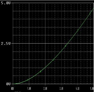

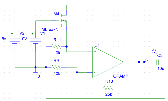

This is what I've come up with. The transistor is an NFET, though I do NOT know the characteristics of what PSPICE models it as... such as doping, length, width, etc. It would probably also be more efficient to use a PFET and an inverting opamp instead of PFET and non-inverting opamp. And all I know about the opamp is that PSPICE models it with a gain of 1x10^6 and I put the power voltages at 5v and 0v instead of 15 and -15. Lastly, V1 that says 0v is your changing input voltage.
I'm gonna go watch star trek :)
since its commercials, this is what it looks like if its 1:1 scale for x:y

Hello again,
Noggin - You have a nice exponential generator but marcus needs to linearize his exponential raw data. If you replace R10 with the transistor you should get a nice log function that could be used to turn a exponential input into a nice linear output.
