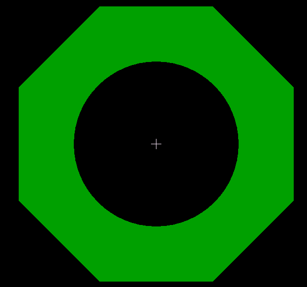

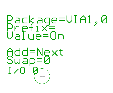

To avoid the ripup of the entire trace you might create solder pads as vias, just a "dot shaped" pin as a symbol. From the symbol create a "device" by connecting it properly (using a package you'll have to design as a single solder pad, defining pad diameter and drill size, e.g. diameter 1.6mm, shape octagon, drill size 0.8mm) Enable the show (pin, pad) function and insert the "via" at any place needed in the schematic making the pins visible. (You need two vias for one layer change and back!)
The via will then be a device which only can be removed by removing the associated pin in the schematic.
These are the steps to create a via as a device.
