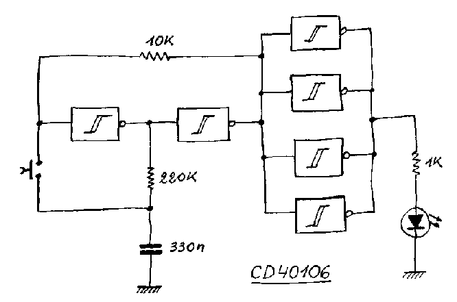

Where do you all look on the internet to find a circuit diagram? I need a simple diagram for a push switch that when I push it once it closes a switch and keeps it closed until I pulse it again (think of spring loaded switch that always disconnects when the presure is released). One pulse turns on an LED circuit and another turns it off.
The switch must run off 3, 6 or 9vdc.

Hi Migs,
Is this the kind of circuit you were looking for ?
on1aag.

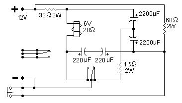

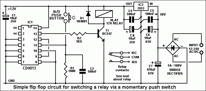

More. Several different circuits.

Hi on1aag and hotwaterwizard:
Thanks for these schematics, I will analyze them and get back to you if I dont understand.
on1aag: What are the "S" Items in the schematic?
Thanks amigos!!! -Migs
"S" items.
Hi Migs,
The CD40106 is a hex inverter, the "S" is not an "S". It's the symbol
that means that these inverters have Schmitt-trigger inputs.
With kind regards,
on1aag.
Hi on1aag:
I would have to use 6 CD40106's for the switch? The symbol on the right is a LED?
Thanks amigo!
Migs
The CD40106 is a HEX inverter. HEX means six. It has the six inverters inside. Lookup its pin numbers on its datasheet.
Yes, the LED symbol is an LED, the resistor symbols are resistors and the capacitor symbol you will have to guess what it is.

Migs said:
Do you know of a circuit like the one you showed that latches the switch closed until the next press?
The CD40106 circuit changes and latches until the pushbutton is pressed again. It is called Alternate Action. Here is a circuit with just the first part shown that is nearly the same but it uses an ordinary CD4069 Hex Inverter IC without Schmitt Trigger inputs. The remaining 4 unused inverters can be paralleled and used as a current-booster like in the CD40106 circuit.
