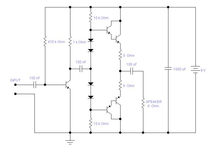

Thanks for the help guys. The speaker i have (i think its from an old broken portable radio) just has '8ohm 0.3W' imprinted on the back of it, thats all i know about it. I just didnt want to put too much power into it, so i wanted to know what the maximum voltage i could feed into it was. So im assuming if i feed in no more than 2v peak (~1.5VRMS), this works out at about 0.25W RMS power. Ive drawn out a design to see if i can do something basic like amplify the signal from an electric mic (20mV) and output it to a speaker, using a 9v battery.
The output transistors are power transistors, rated at 1A. The others are BC547B, gains of about 300. The resistors on the emitter's are there to stop thermal runaway, i wasnt sure what value to use, as ive seen many different values in other designs, so i put in 8ohm, to try and make output impedance = input impedance of the speaker, and have maximum power transfer.
Originally i calculated to 470k to be 5M, to bias the collector at mid voltage and get maximum swing, but this gave a non symmetric output. I think the combination of the 100n coupling capacitor and this resistor might have been acting like a filter. I didnt want to reduce the 100n because i wanted to couple the low frequencies from the input, so i reduced the resistor down to 470k, which seemed to work.
With an input of 20mV, the peak voltage across the speaker is about 1V.
Would this be a good circuit to try, or can it be done much simpler.
Thanks in advance.
Megamox
You don't need 1A power transistors in a simple amplifier producing max power of a puny 250mW. The BC547B and BC557B are rated at 500mA and will be fine by themselves.
High power amps use emitter resistors but your have the diodes to stop thermal runaway.
Amplifiers don't match impedances for max power transfer. They have an extremely low output impedance for low voltage loss and good damping of the speaker.
Where are you going to find a transistor with a gain of exactly 300?
What happens to its gain when the temperature changes?
What happens to its operating current when the battery voltage runs down?
How much distortion does a transistor have without negative feedback?

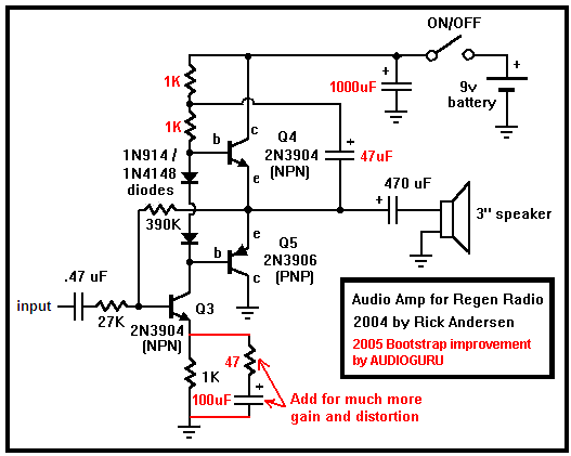

I think your amplifier has too many transistors and needs DC and AC negative feedback. Here is a much simpler amplifier that works very well, but needs a separate preamp transistor to operate from a microphone:

Thanks audioguru! I figured that id need a rating of 1A because at the highest output, the emitter would be at 7.6V across the 8ohm = 950ma? When i said the gain's were 300, i meant on average, id like the circuit to be indepedant of small hfe differences in transistors. Btw what does the bootstrap part of the circuit you added do? It seems like a capacitor on the emitter will reduce the AC impedance of the emitter and have larger swings of current through the transistor - at least thats what happens when a cap is added on the emitter of other common emitter amplifier's ive seen.

As Audioguru says, you DON'T match impedances in transistor amplifiers, it's a really BAD idea. However, I disagree with Audioguru about not requiring the emitter resistors at all, I would always fit them to help prevent thermal runaway, which the diodes on their own wouldn't do.
Personally I don't like the two diode method of bias compensation, and with no resistors it's highly likely that the amp will destroy itself - unless the diodes are perfectly matched to the transistors, and extremely well thermally coupled to them. I far prefer to use a Vbe multiplier, so you can adjust the current, yet still get the same thermal compensation.
Bootstrapping (or some other constant current source) is vital if you want to get any sort of power out of the amplifier - the base current for the top transistor is provided by the resistor from the positive rail, as the base swings positive the voltage across the resistor gets less, so eventually it can't provide enough base current to the transistor. This causes low power and horrible distortion, with good negative peaks and poor positive ones.
BTW, your design would suffer from the same problem on negative peaks as well, so it's not very practical at all!.
Unless the design is for a specific school project?, I would suggest using a small IC amp - far easier than a discrete design.
The emitter-followers have a very low output impedance. They drive the bootstrap cap with about the same signal as their input:

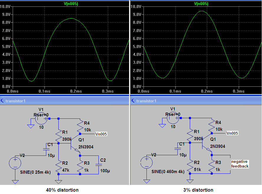

1) the junction of the 1k resistors actually swings above the supply voltage. Therefore the NPN transistor has low loss.
2) The lower red 1k resistor has the same signal at both its ends resulting in a constant current through it. The constant current load for Q3 is very linear reducing Q3's distortion dramatically, and since it is a very high impedance then the voltage gain of Q3 is very high.
Here's a sim like I've seen on my 'scope many times of a transistor like Q3 without bootstrapping and without AC negative feedback. Its distortion is awful and is so high that you can't measure its voltage gain.

Just a quick question about the power ratings on the output PUSH-PULL transistors. Maximum current is drawn when they're around 4.5v and that current is 562ma. So the power in the trans is (9-4.5v)*(562ma) = 2.5W.
The 2n3904 is rated at 500mw, wont that be a problem?
Transistors have a very low current gain near their max collector current. The 2N3904 and 2N3906 have a max collector curent rating of 200mA, but their current gain is a minimum of only 30 at 100mA. They don't have enough input current and don't saturate well at high current so the voltage across the 8 ohm speaker will be much less than 4.5V peak.
The two series'd 1k resistors feeding current to the upper transistor have about 1.9V across each one which calculates to only 1.9mA. With a current gain of 30, the collector current will be only 57mA. If the current gain is 100, the collector current will be 190mA if the transistors saturate enough.
You don't operate audio amplifiers continuously at max output. The average power for music and voice is about 1/10th the max. These little transistors won't heat much in this simple amp circuit.
Just had a thought, if we added another 2n3904 in parallel with the PUSH 2n3904 and fed the base from the same input, the collector currents would be divided equally between both of them, so each one would have half as much current and so a higher hfe. Would this work and push more power into the speaker at peak?

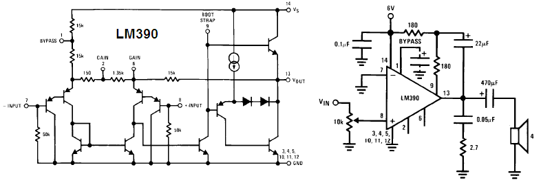

The simple amp circuit is cheap and simple. It doesn't have power transistors driven by driver transistors like real amplifier circuits.
I use the LM390 little amp. It is like an LM386 on steroids because you add your own bootstrapping to allow it to provide nearly 1W to a 4 ohm speaker with only a 6V supply. Its too bad it is discontinued but I still have some.
