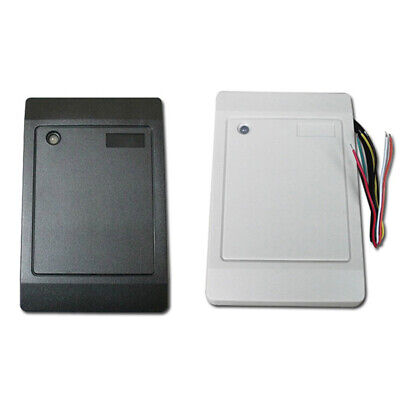

If you want to make a door entry system, there are lots of wall mountable reader units on ebay etc., though they often have Wiegand format output rather than UART style serial.
That uses two data lines & pins on the MCU, one being pulsed for a zero bit and the other being pulsed for a one bit.
It's very easy to build up the full number, just a different way from a normal serial data string.
Search "Wiegand card reader" on ebay and you will find loads of things such as these:

As I said earlier, there are two totally different frequency systems & any one reader only has a chance with cards using the same frequency.
And there are also different data standards in various cards/tags using each frequency.
eg. That ebay listing says it is for 125KHz "EM-ID" cards, so it won't work with 13.56 MHz and may not work with 125KHz ones that use different data formats.
