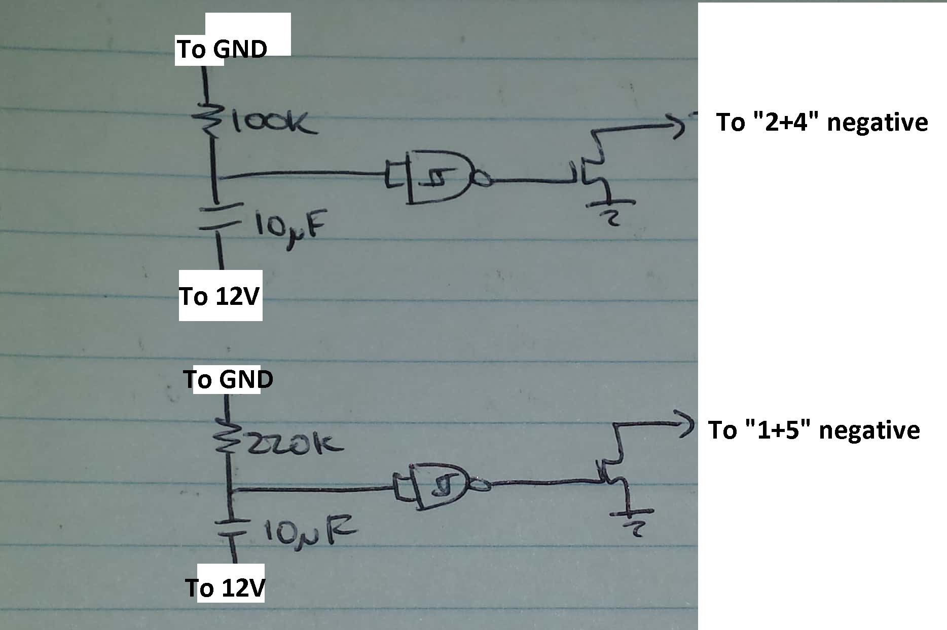

Hi all, I am new here, just registered to see if any of ya'll can help. I am trying to find a project/kit to control lights I wish to put in my car.
Here is the idea. I wish to fit 5 x COB 150mm long LED strips in red, which are to be brake lights. I want press the brake pedal, and the middle/central 1 will light up and stay on, followed by the ones either side of the middle one to light and stay on, then the outer most 2 to light and stay on, so all 5 lights will stay on whilst the brake pedal is depressed, then all go off when the brake pedal is released. So the sequence will be 3, + 2+4, + 1+5, all on, all off.
Has anyone already done this or is it something new? I've tried looking online but as yet haven't found any builds to match.
In a few modern countries, it is illegal to tamper with the lighting on a road vehicle because the new lights might be too dim, too bright or not have a wide enough viewing angle. Your idea to begin with some lights then add more lights would not be acceptable.
You can use two timers to turn on the "2+4" and "1+5" LEDs after a delay. The "3" LED is always connected across the power supply. The power supply is taken from the existing brake light.
For the timers, you can use half a 4093 (schmitt-trigger NAND), or similar, or two 555 timers. I've attached a schematic for the 4093 version. As shown, I think the delay will be something like 0.7 seconds, and 1.44 seconds for the respective LEDs.

Dougy, thats great, thanks. Can I ask, what are the bullet shaped things in the diagram? Also, the 100k and 220k resistors are the time control/delay rights, so I can try bigger resistances or even variable resistors in their place?

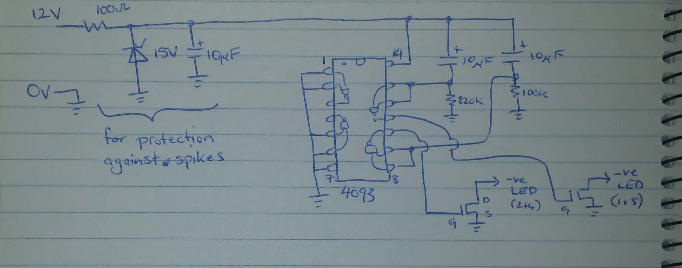

I got this image online of the 4093, which terminals do I connect to what please?
Sure:
118543
I added a resistor, zener diode and capacitor (on the left) to hopefully get rid of voltage spikes from the alternator. The transistors that are driving the LEDs (terminals marked with "G"/"D"/"S" - i.e. gate/drain/source) are N-channel mosfets; choose some with voltage rating above 20V, and current rating above whatever the LED strips use.
So I have been searching online for the 4093 ic diagram, and quite a few internal circuits come up, so I am confused even more now.
The 4093 only has one pinout that I know of, which is the one you posted first.

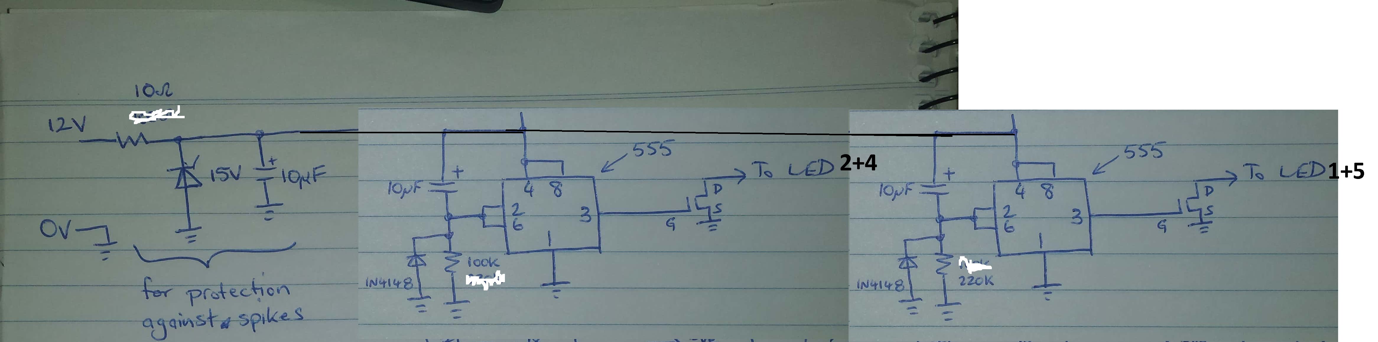

Hi Dougy, thanks alot for that, that makes alot more sense now. Sometimes more detail is easier to understand. Yes, could you do a schematic using a couple of 555's aswell please, I have 2 sitting around I can use anyway. Thanks again.
If you already have the 555s there, then all the better. Here's the franken-schem:
118547
And regarding your question about using a variable resistor in place of the resistor, yes, you can. The delay is proportional to the value of the resistor.
EDIT: the 100 ohm resistor on the left should be reduced to possibly 10 ohms, because the 555 timers use more current than the 4093.
you're welcome, and good luck
