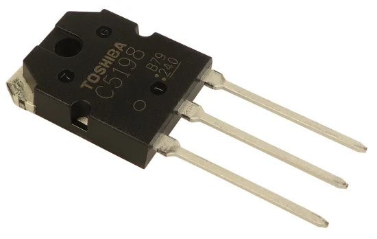

I'd change the five (seven?) pairs of output transistors (the large ones mounted to the heat sink below the main circuit board). They are cheap and sometimes only fail when warm so, I'd just change the all as a first attempt. You can go through and try to diagnose which ones are bad but kind of hard when failure is intermittent as you show.
Hey thank! Just to double check I've got the right thing from your description, they look like this and are held on with one big screw in the middle? You can see just one in the second image from the top, below the blue wire going to the brown board?
Yes, check the datasheets. There is a pair for each output channel - one NPN and one PNP. The L and R may be bigger or more expensive than the rear surround channels. Check the part numbers on all before ordering.
Also, the bottom "porthole" of the chassis usually comes off to let you desolder them without taking the whole thing apart.

Randomly changing components is a VERY bad idea - and more likely to cause further problems than cure anything.
Finding replacement transistors could also be an issue, as output transistors are commonly faked by China, and it's difficult to get actual proper working ones.
A protection fault most likely means that ONE of the channels is faulty, you need to find which one, and repair that one - easily found with a simple voltage test on the outputs before the relay. Find which one, work on that.
As it worked for a while after he got it home, then a simple dry joint seems most likely, and checking round the output stages visually for dry joints (particularly on the output transistors - or anything else 'large'). I repaired quite a lot of surround sound amps that just had dry joints.

Yes, it can mostly be found by a visual inspection - larger parts (such as the output transistors, emitter resistors etc.) are more prone to it.
